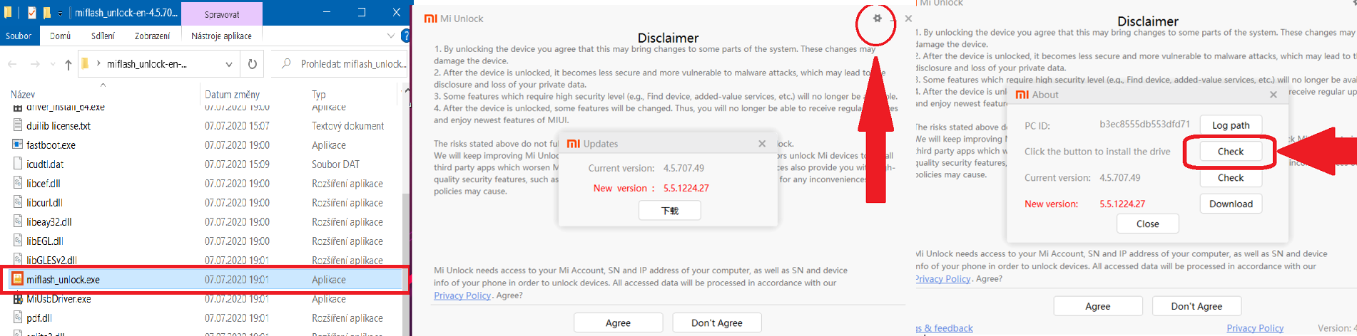

Im beginning to get frustrated asf by this nothing works... Every driver is installed but xiaomi unlock tool still doesn't recognize my device. I can't see my device folder when im in fastboot either nothing works.
You only have to install the drivers. Nothing else, no unlocking.
