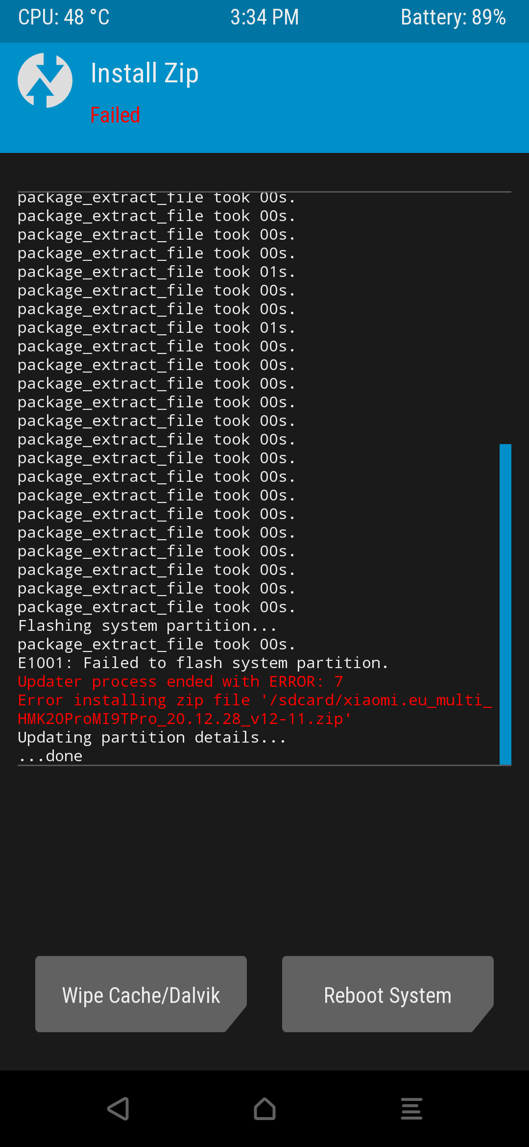

Hi guys
Can't install on K20 Pro Premium via TWRP 3.4.0-1
Anyone knows how to pass this problem?
Previously installed -- xiaomi.eu_multi_HMK20ProMI9TPro_20.12.9_v12-10.zip
Trying to install -------- xiaomi.eu_multi_HMK20ProMI9TPro_20.12.28_v12-11.zip
I'm using dirty flash

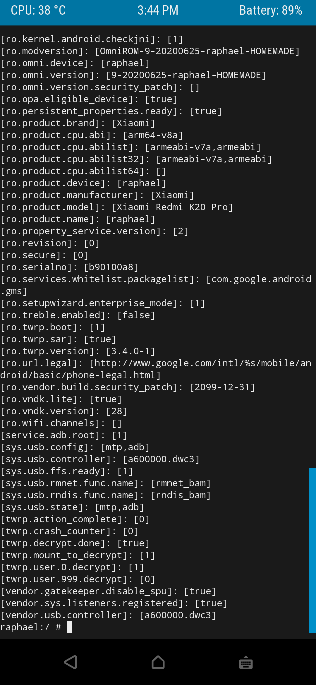

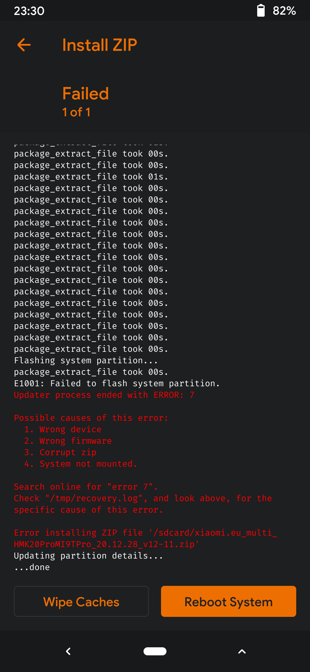

Are you sure? Clean flash may not solve this line :emoji_thinking:
Quoting from xiaomi.eu_multi_HMK20ProMI9TPro_20.12.28_v12-11.zip\META-INF\com\google\android\updater-script file
block_image_update("/dev/block/bootdevice/by-name/system", package_extract_file("system.transfer.list"), "system.new.dat.br", "system.patch.dat") ||
abort("E1001: Failed to flash system partition.");
Just give it a try with OrangeFox recovery and here is the result. It's the same
I got success with re-downloading the zip file again.
Seems like the maintainer have re-uploaded the ROM, and I was trying to install a broken one.
For those who are still suffering with the same problem, I suggest you to re-download or at least make sure your ZIP file have the same MD5 hash with the latest upload
