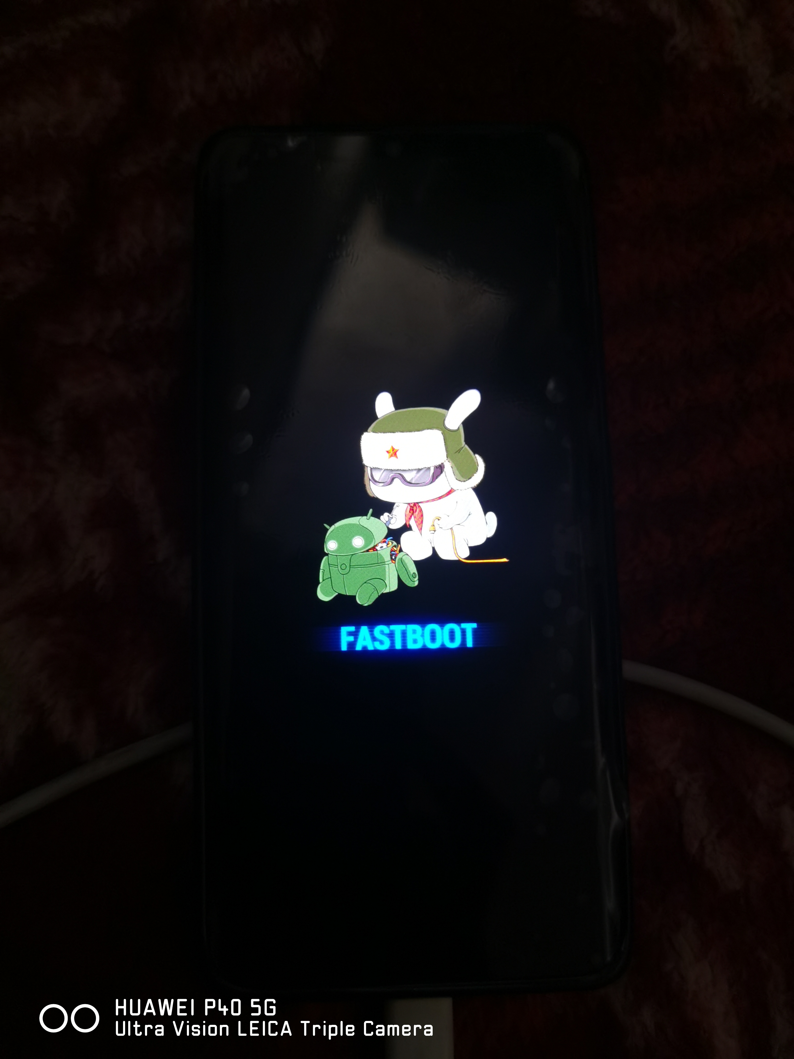

Sir, i have updated my mi note 10 lite to android 11and after restart it works fine. But the problem is that when i reboot to recovery to install root, because i have installed twrp before. Unfortunately, its stuck on fastboot screen.
Can you help me out to solve this problem. I tried to flash fastboot rom through mi flash tool it errors because anti rollback.(android 10)
Still i am finding Android 11 fastboot images but not found.
You don't need to flash a fastboot ROM but flash a working TWRP for your currently installed ROM version. ;)

Holding " Power " and " Vol - " buttons doesn't boot to fastboot? Your device has a hardware issue if it's the case. :(
Good news sir, after 15 minutes of charging its turned on and this screen appears. No twrp recovery available.
I flashed the recovery, after booting its successfully boot into twrp.
When i flash rom its errors because of partition mount failure. If I reboot to recovery its boot into fastboot

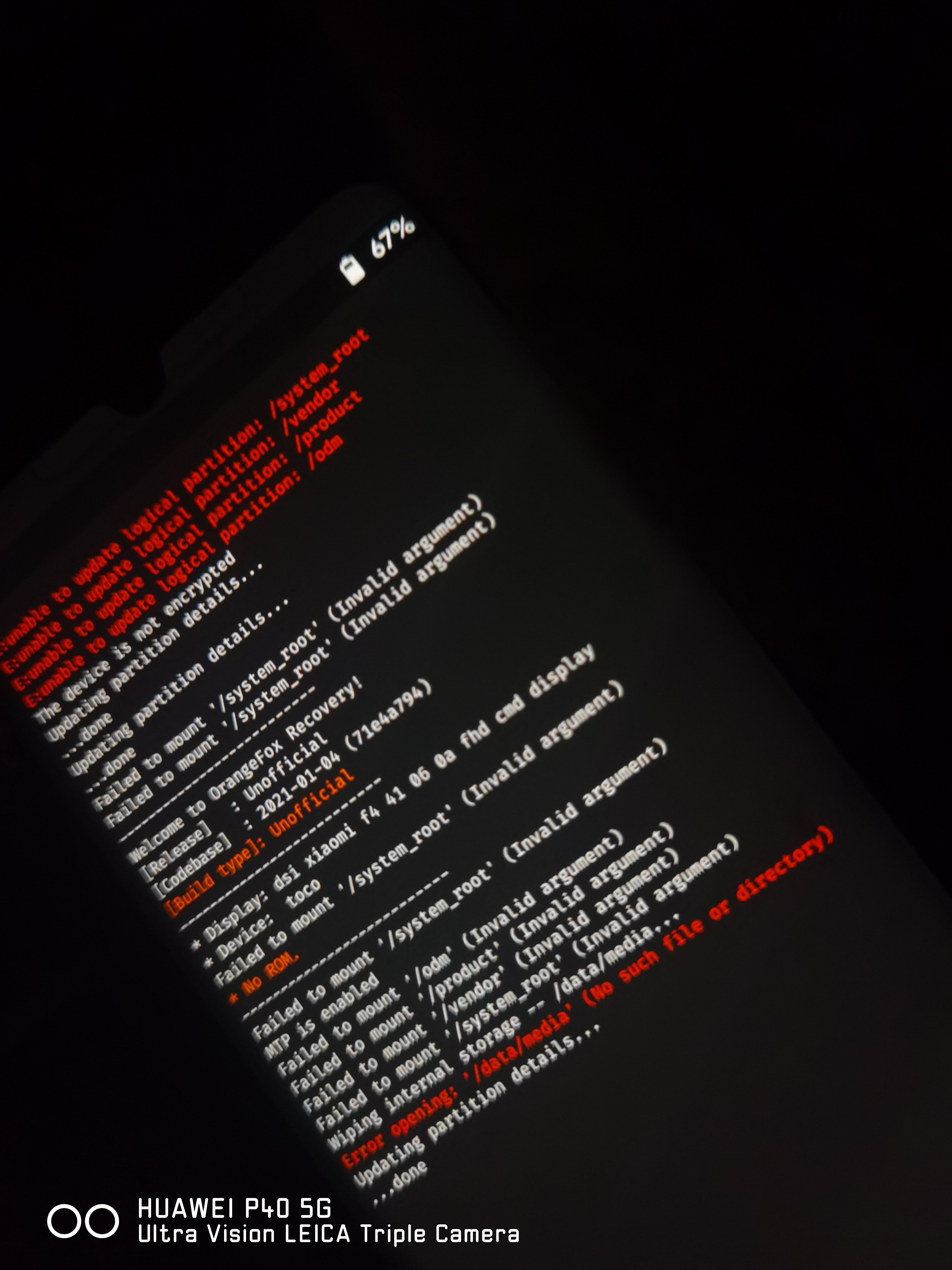

I have
Humble request please read this
The device is not encrypted
Unable to update logical partition : /system_root
Unable to update logical partition : /vendor
Unable to update logical partition : /product
Unable to update logical partition : /odm
Failed to mount '/system_root. (invalid argument)
No Rom
MTP is enabled
Twrp showing this,please anybody help

two possibilities - try them in this way before format data
  • flash the newest twrp for your phone and try it again (fastboot flash recovery [your image file])
  • extract "boot.img" from actual installed rom version - unzip the "rom-xiaomi-eu" which you have flashed and you will find "boot.img"
    • start your phone in fastboot
    • fastboot flash boot [your extracted boot.img]
    • reboot
