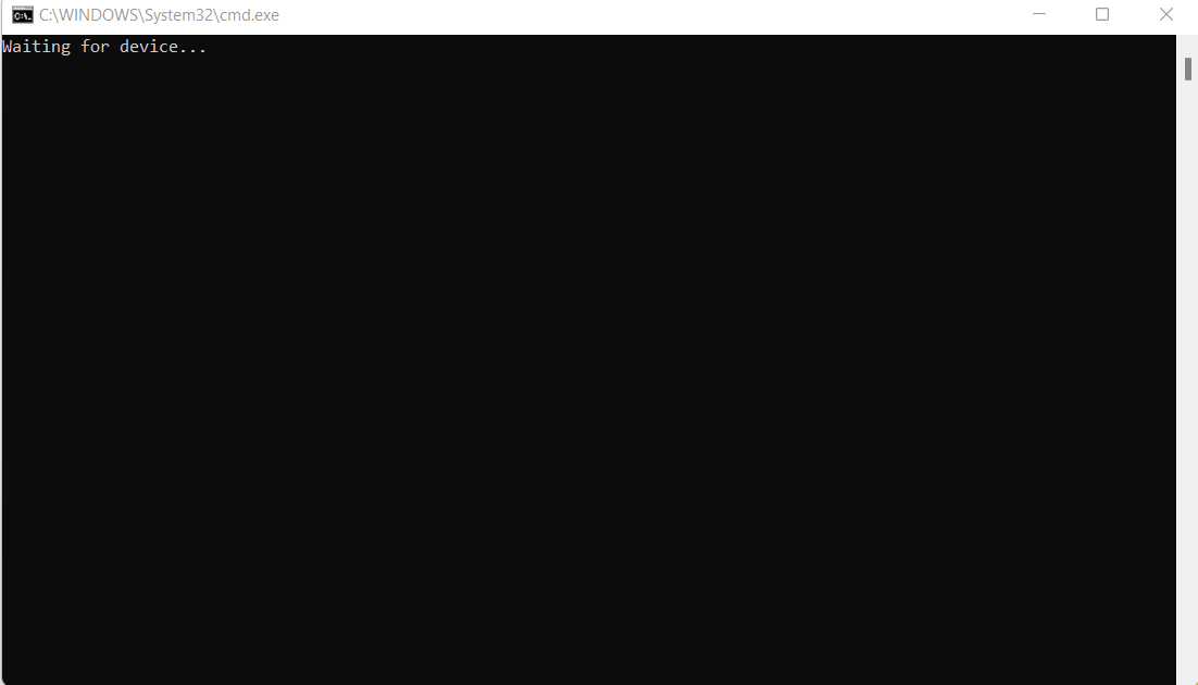

Hello, unfortunately I can't get any further. I'm stuck trying to update my xiaomi smartphone. it keeps showing waiting for device, can someone help me?

And also try another cable ou via a usb hub.. I had the same problem, it would recognize via adb but not fastboot. I tought the cable would not be an issue because I was using a high quality 60w rated one.. But trying with another made it work.
This thread helped me to solve the program problem, which was probably due to the driver. I installed it while my phone was in fastboot mode and connected to the PC
