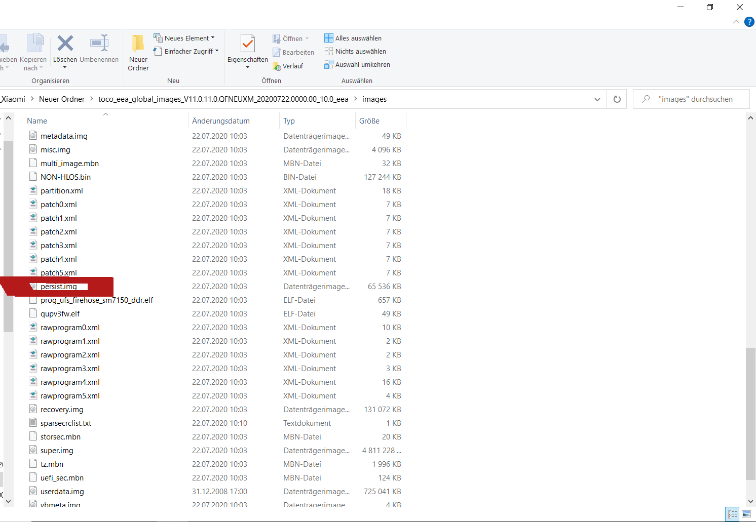

Is it that file, could it be?
Its inside the official-global-image, at:
toco_eea_global_images_V11.0.11.0.QFNEUXM_20200722.0000.00_10.0_eea\images\persist.img
But its probably better to extract it from V12.. because I already use a version 12 or is there no big difference?
Yeah, that's the file. It's better to flash the persist.img that corresponds to the version you have installed now.
