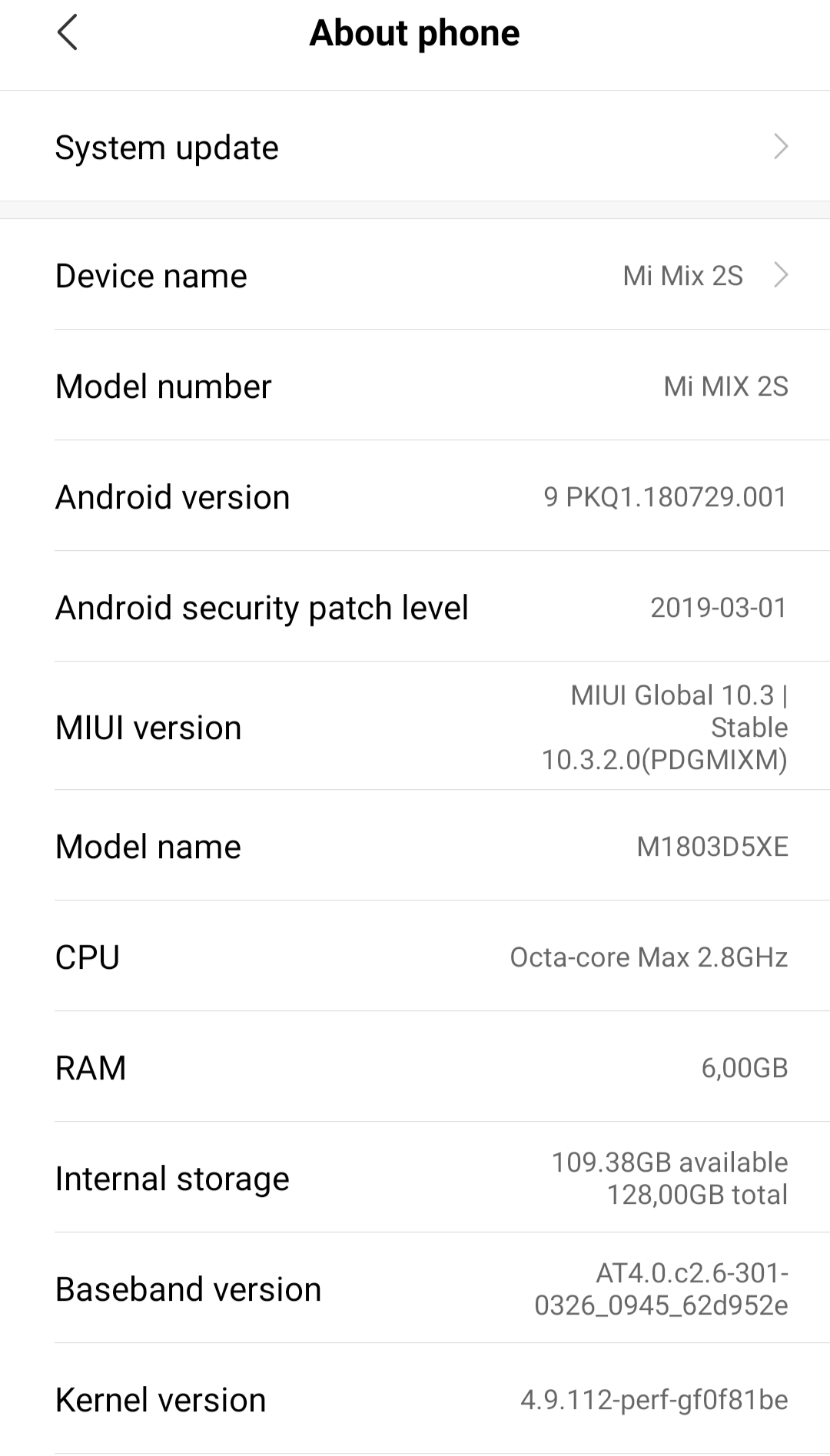

Latest TWRP, Magisk & Xiaomi.eu...
Mi Mix 2S 6GB/128GB
MIUI Global 10.3 Stable 10.3.2.0 (PDGMIXM)
Bootloader UNLOCKED
NO root

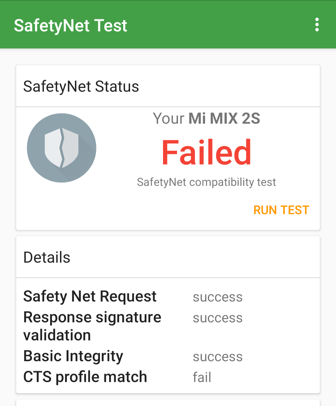

I notice my "Play Protect" certification in Google Play has now gone to "not certified". Fresh install of the whole phone and I couldn't get it to accept cards.
