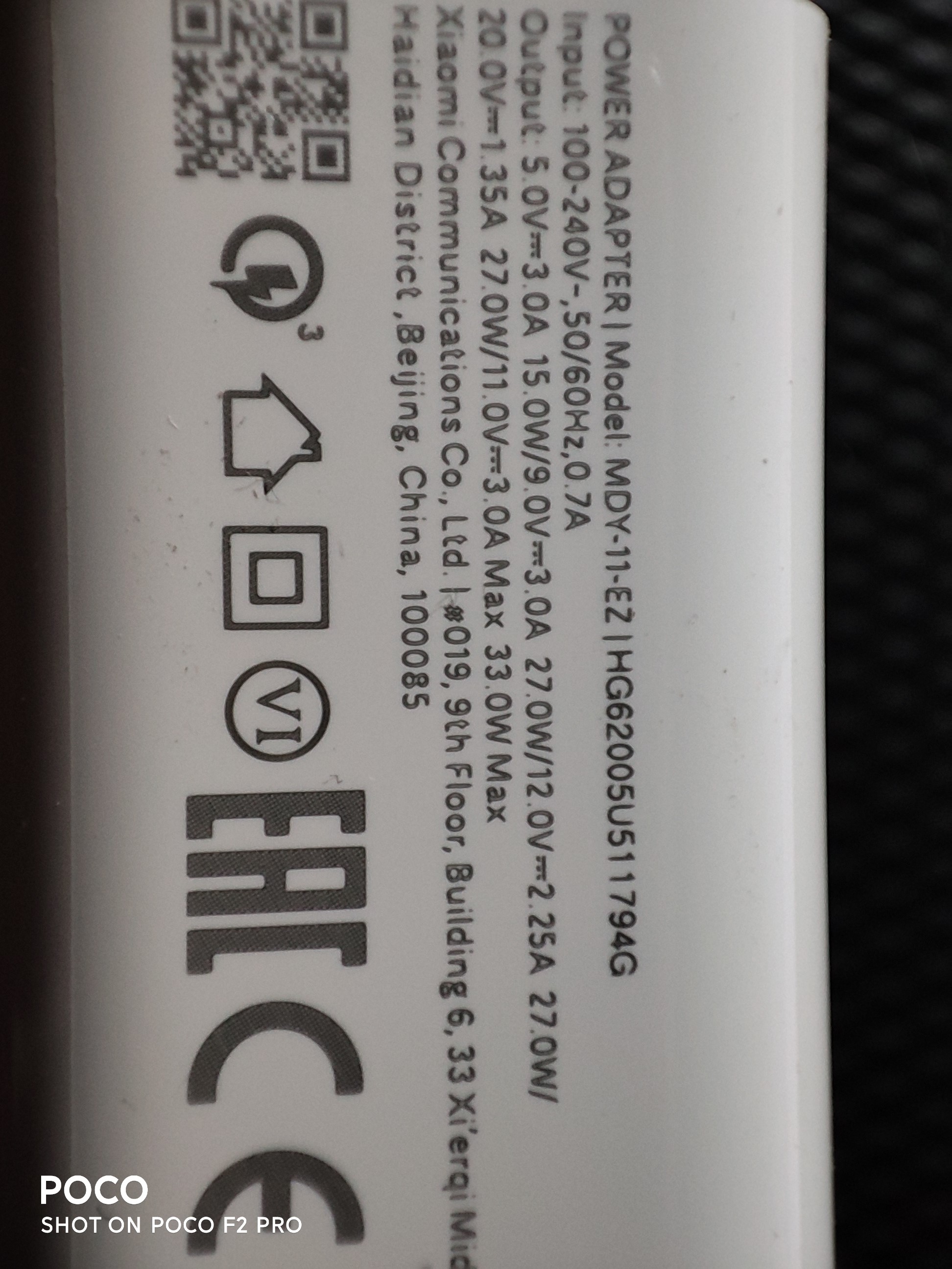

I charged my battery between 20 to 90 percent, also use 30watt charger .
what about this charger? is it good for my Poco F2 pro
