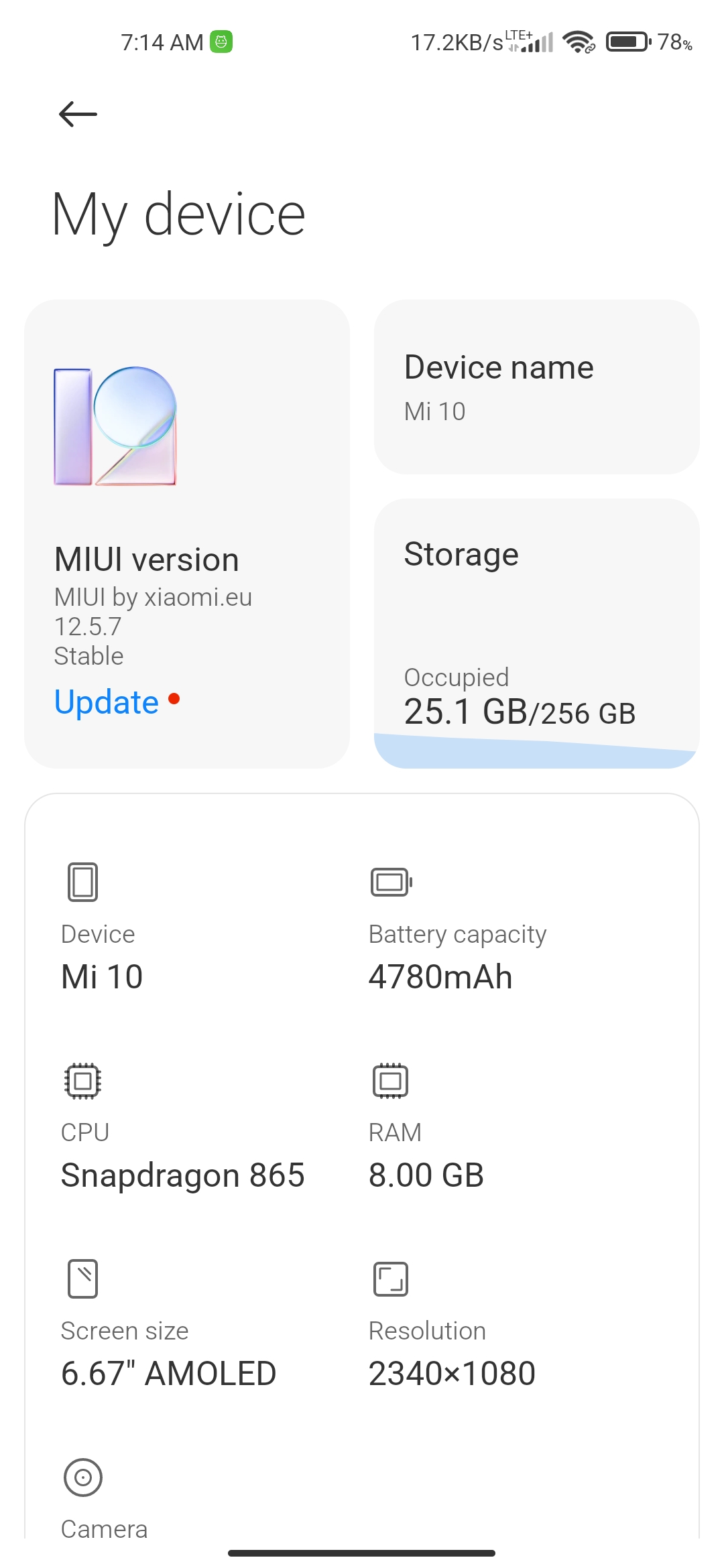

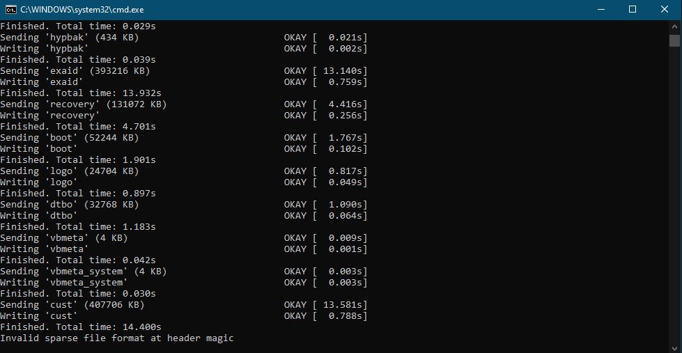

i successfully converted a twrp rom to fastboot rom version (12.5.7 stable EU) umi
luckily i found old backup of super file created with twrp backup
just added all needed files including my exclusive super.img file to miui 13 fastboot script structure
just 1 little error during extracting super file
invalid sparse super file format
after that it starts flashing normally
