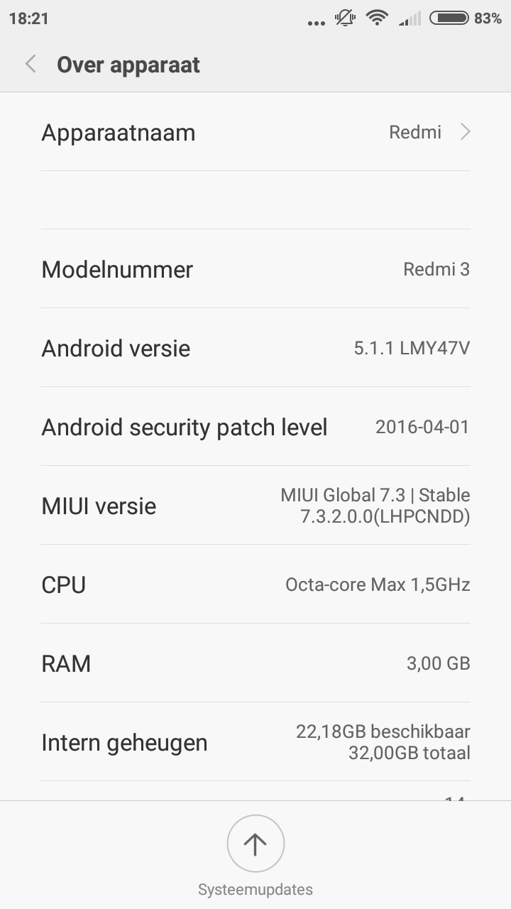

1) Setting, About phone > write MIUI version

I have MIUI version 7.3.2.0.0.

I also found out trying to first flash the official China development ROM (and properly also the just released official global ROM) for the redmi 3 pro FAILED via the updater app. I downloaded the zip file (China development full ROM) and select it via the updater app. My phone reboot, for some time I only see MI logo and reboot again... It just boots into the unchanged vendor ROM again... See screenshot of the version.
I really need to get this working before I can unlock my bootloader. Please help, it's not my first time I am flashing ROMs (did it before on HTC desire & Samsung Galaxy) and I'm a software engineer. So I'm not a noob, still this looks like a blocking issue.

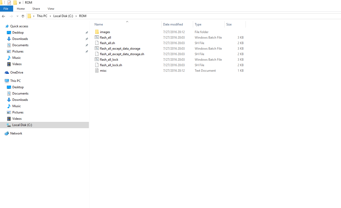

  11. Extract the .tgz ROM file you downloaded at step 4. Extract the tar inside again, into a good location (like C:/ROM). See my the attached image (extracted.png) how this looks like.

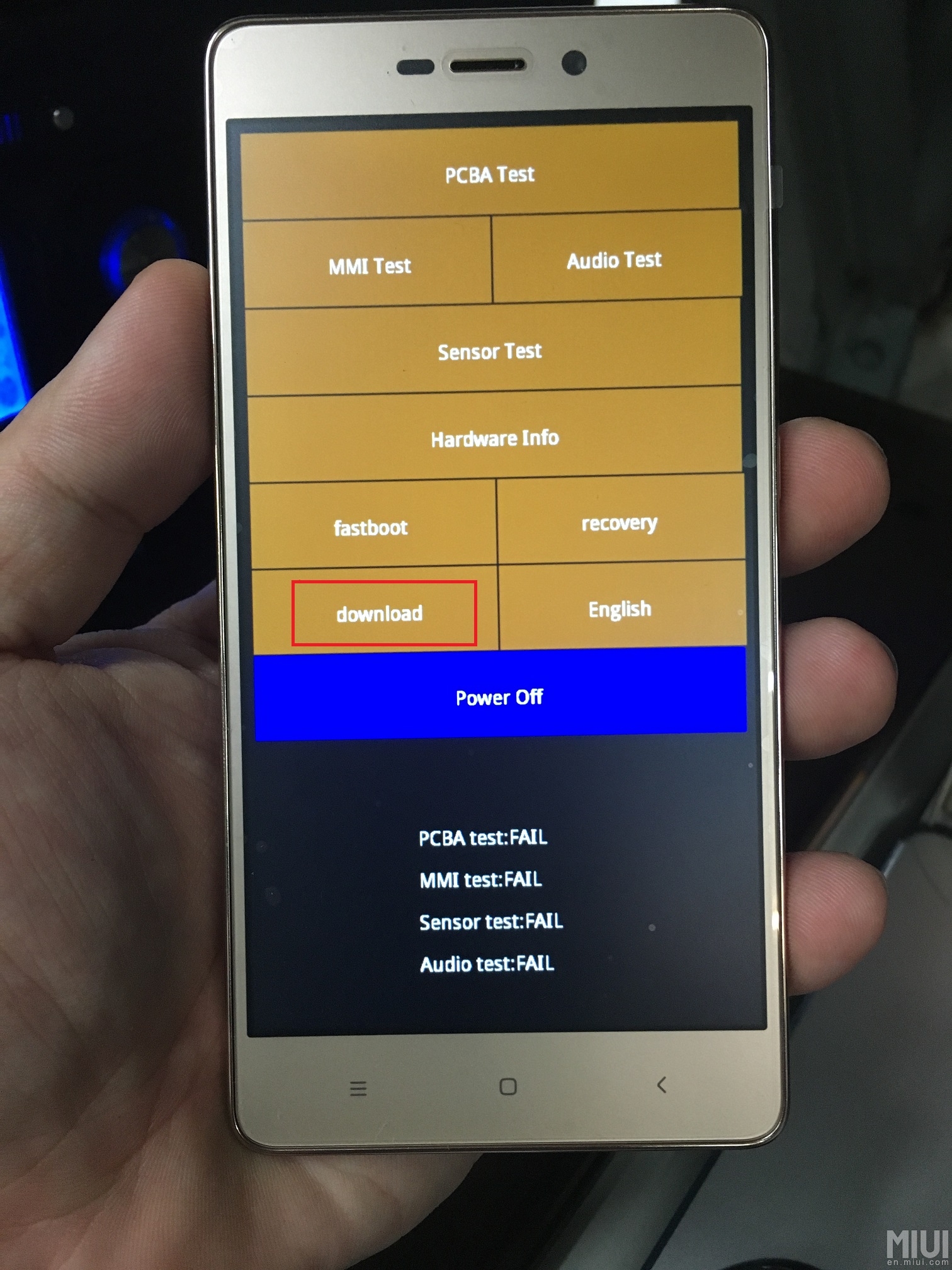

  13. Shutdown your mobile, start your mobile in recovery mode by pressing Power up button + Power button (at the same time).
  14. It could be you see characters in Chinese, press the Download button in this menu. You could change the language to English by clicking on the almost bottom right button.. grr, this is horrible to explain in text. So see the image I attached where the Download button should be. Click atleast on this Download button, your screens goes black (that is good). See download_button.jpg in the attachments.

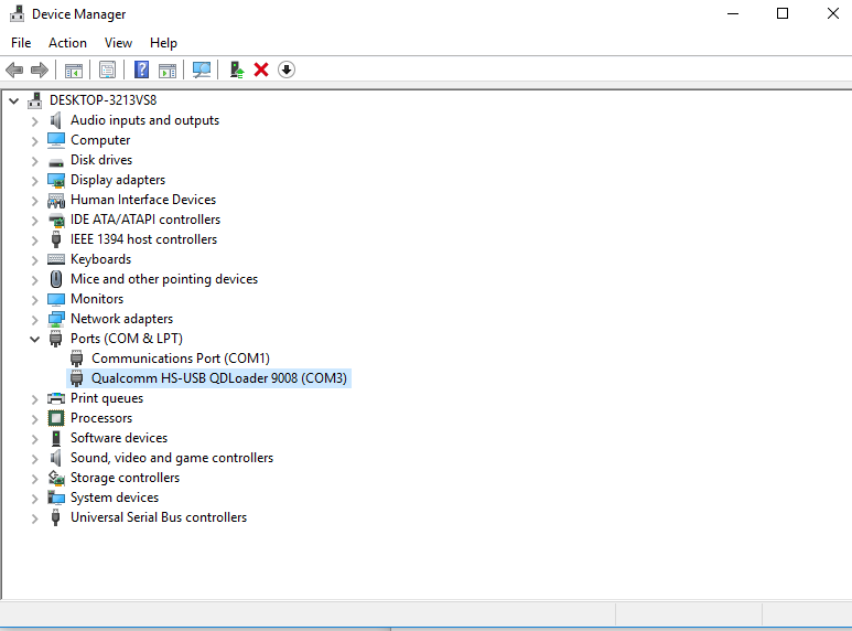

  15. Attach the mobile to the computer via a USB. You should see Qualcomm HS-USB .. in your Device Manager of Windows. See attachment as well (device_manager.png)

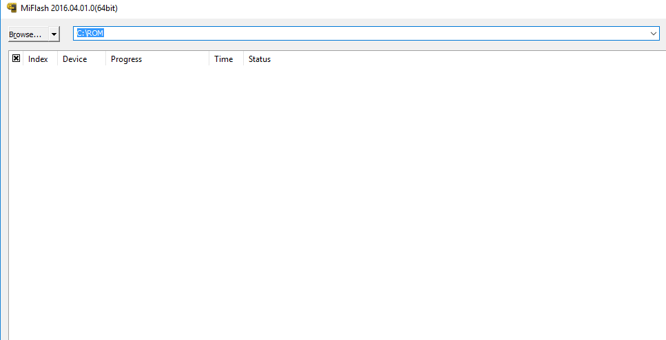

  16. Open the MiFlash tool, browse to C:/ROM (NOT C:/ROM/images). Press the refresh button to see the attached devices (COM3). See miflash.png.
  17. Click COM3 and press the ''Flash"button. Finally the ROM will be flashed to your mobile phone. Do not unplug the mobile phone from the usb!
