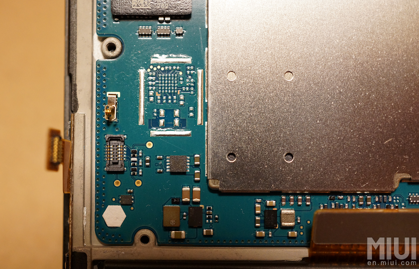

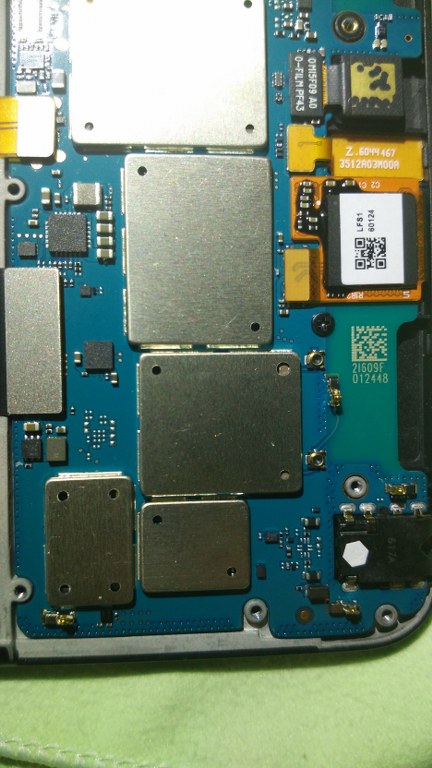

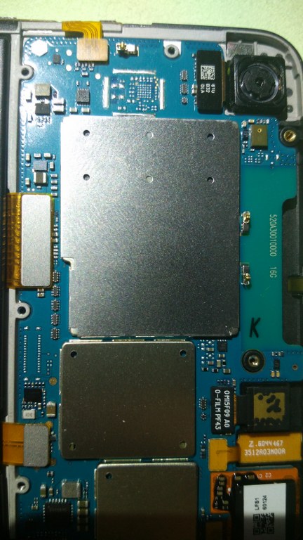

Your guide is not working , I brick 2 times and contina does not work ... finds errors because it can only damage
PLEASE HELP ME ....
I have bricked my pad i have opened a thread on miui.com
because i can not open here ,i have to post sometimes first. the only way to fix this problem is to find test points of the motherboard ot jtag point to force
pad in dnx mode so we can flash a new rom but no one could tell me yet about these points.I HAVE FOUND SOMETHING similar for MI PAD1 .I CAN NOT POST URL FOR THE SAME REASON

Unfortunately no. No one yet help for this problem.
