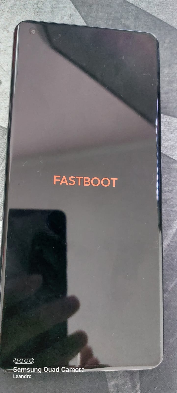

helpe me mi 11 ultra
leandro2k
13 Nov 2022
11
stayed on this screen, it doesn't come out, I already tried to install the rom again, it gives an error

Did you use format after flash? Different ROMs have different partition differences.
If you are in fastboot, you can format data.
Which ROM are you installing? If it is the EU ROM, then there is a script that will format data after flash. It may be that your flash went wrong too, so just flash it again as long as your bootloader was unlocked. If it wasn't, flash the original stock ROM and unlock, then flash this version again.

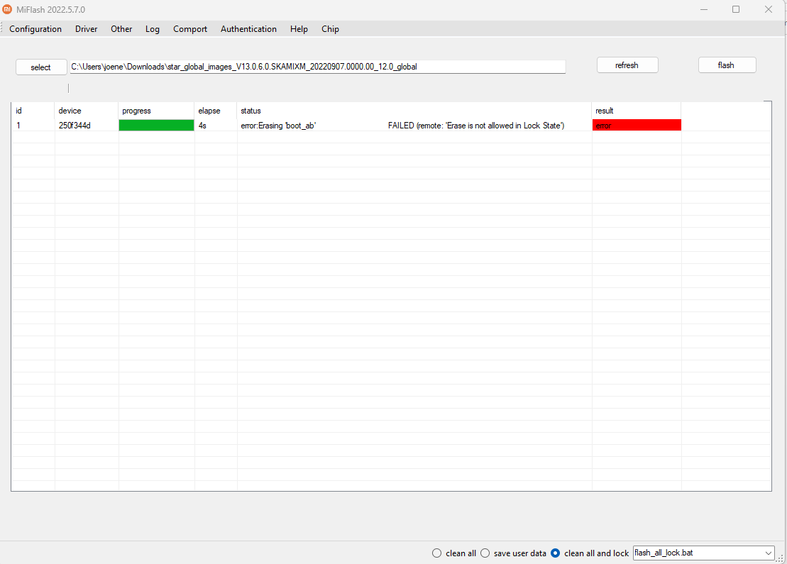

so I think it's blocked because my flash always gives me an error, I'll post the photo

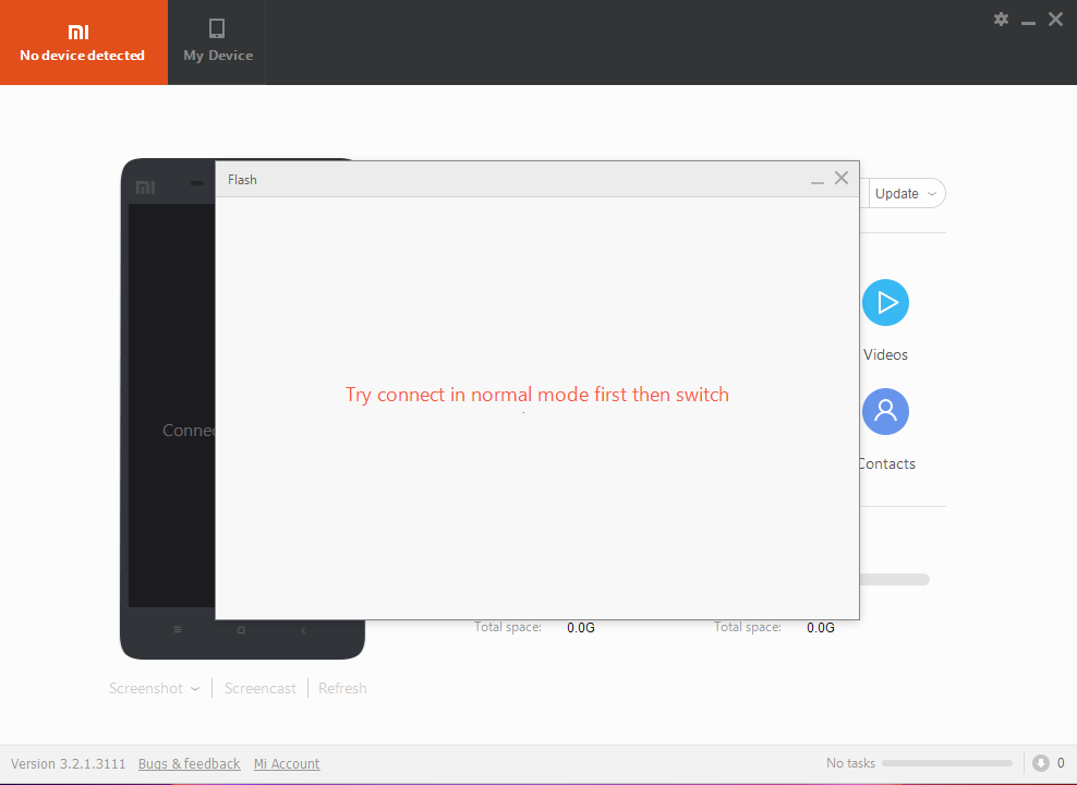

program recognizes the smartphone but I can not perform the recovery

Please write only in english, it´s a rule here and it´s easier to work together. The biggest fault is to mark clean all and lock in Mi Flash, because after this your device is locked and no rom installed. Please sort your posts and write down, whats the actual status of your device (locked, fastboot, original rom before flashing etc., not 100 posts with different conent and languages). To read and understand is very confusing.
