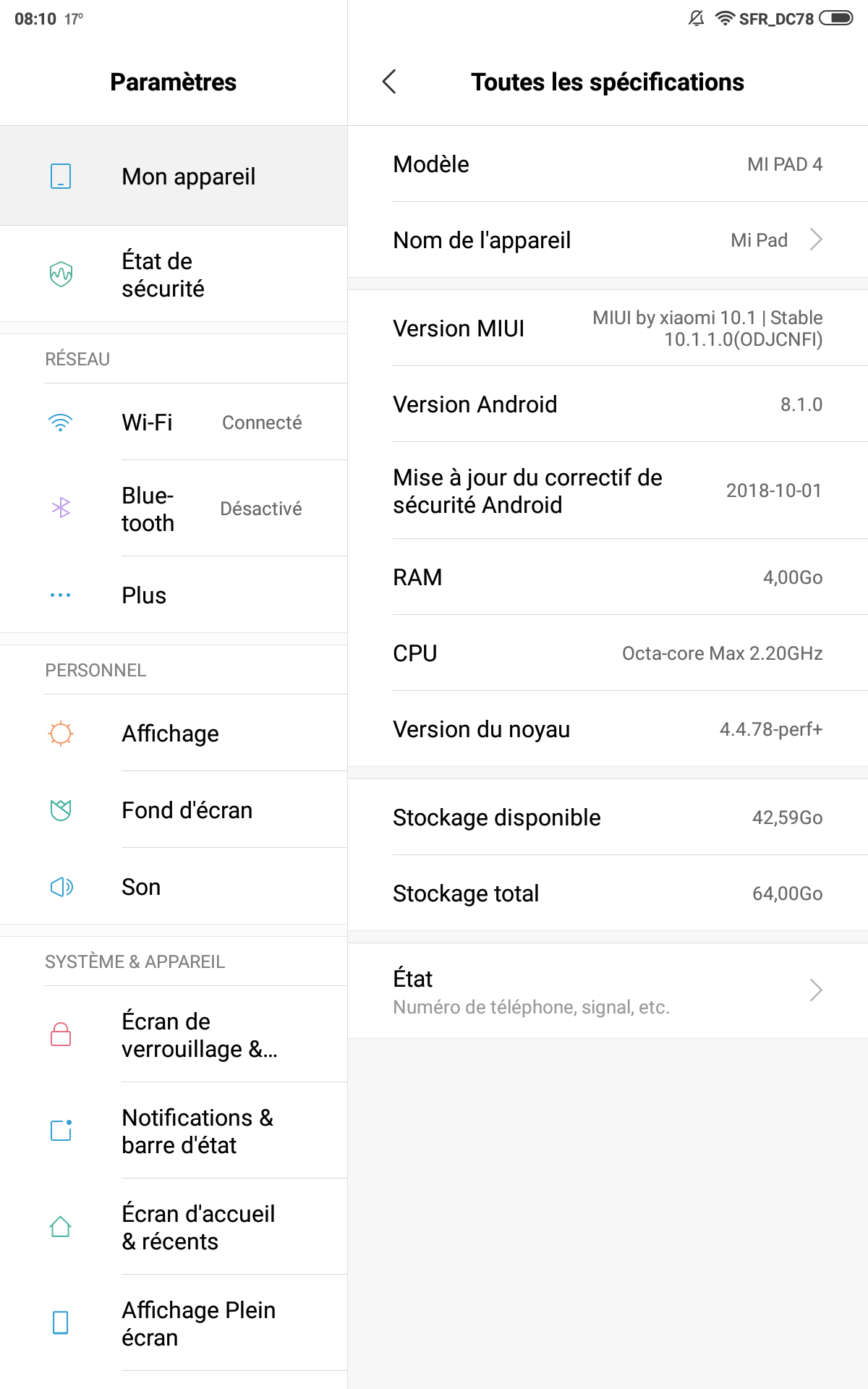

Hello
I bought my mipad4 few months ago.It is already french with Google play but non OTA .
24832
If someone could tell me what Can I do now if I Want to get upgrade and if I really need to ?
Thanks.

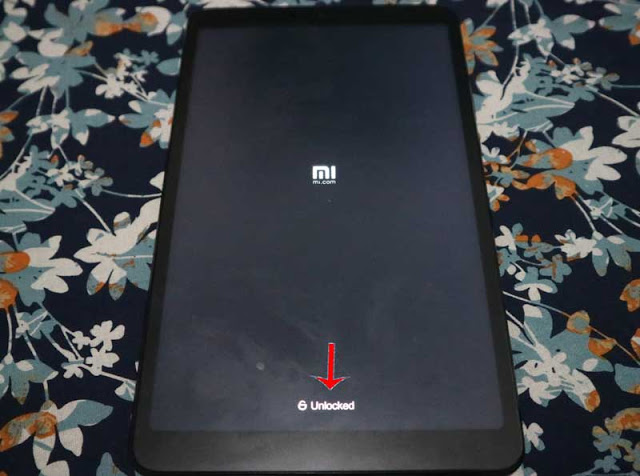

I 'm pretty sure it's already unlocked ,
The padlock is open when I open the mipad 4. Is that right ?

Yes on the lock screen at the bottom it will say unlocked....

iamme729
Nov 22, 2015
1,751
142
You're good to go ...install TWRP if not already installed and flash Xiaomi EU ROM ....
