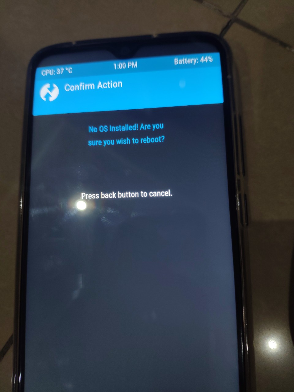

Hi everyone,
I want install rom EU on my Redmi Note 8.
I was unlocked and installed rom Global with MiFlash.
Im was intalled TWRP.
But when i install file rom EU with TWRP then my phone No OS Installed.
Im tried again but not anything change.
Someone can help me to install rom EU.
Many Thanks!

Hello i think it's not possible i try 3 différents twrp and i have the same results : impossibe to install an alternatives rom ( xiaomi.eu or ********) at the end i take official fastboot global rom and my flash and i istall this and i lock bootloader

I want to be sure you did format data in twrp wipe section, as requested before flashing EU rom from stock?
Hello yes wipe data data dalvick i erase all data and i have too bootlop twrp

Instructions given first page are fine:
-Format data/yes in recovery
-reboot recovery and reload EU zip
-flash EU rom
-reboot sytem
that's all

I don't want you stay worried
This morning i fighted with a new Redmi8 having the same difficulty to get stick TWRP.
what I did to go flashing EU stable rom:
I booted into TWRP and did a format data.
I then flashed lastest EU stable by mean of my USB stick because I was having issue with linux to paste the zip into the phone.
(Should work direct with win10 under twrp MTP.)
At the end I flashed TWRP and it was back at reboot! Encryption working as requested!

Simplemente reinicie su teléfono. El sistema se instala incluso si aparece ese mensaje
