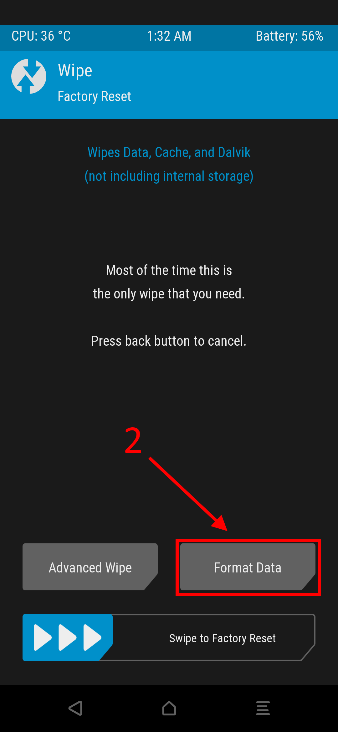

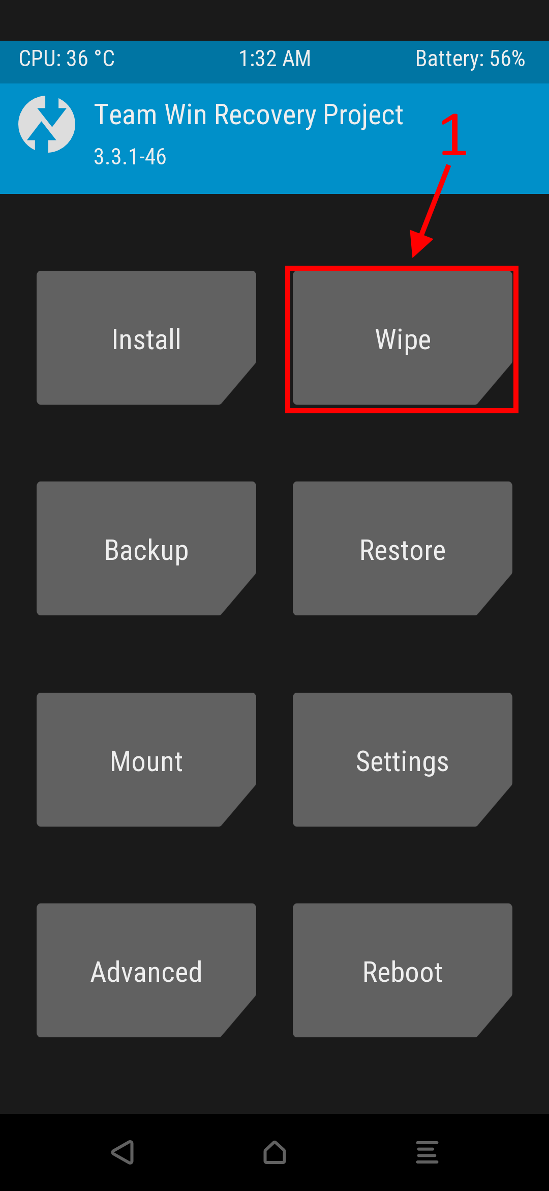

When flashing from beta to stable and vice versa, other than a wipe, you should also perform a format data.
In TWRP, after you had flashed your desired ROM, go to Wipe, then tap on Format Data. You will lose your data and hopefully, you had done a backup prior to this.
