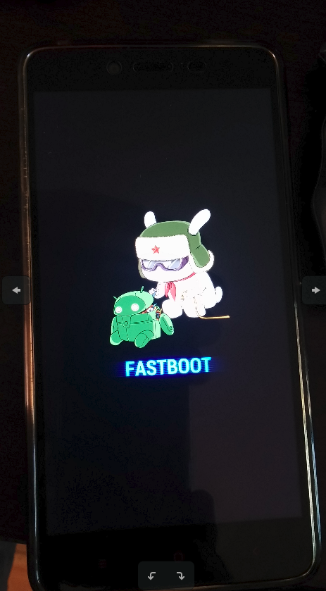

Hello Gelopa
I am unable to Root the device, I have followed the step by step clearly until "Next - we're going to root the phone and then install the new ROM:". After that am not able to get the next step "1. Power up your phone into the new TWRP recovery which has replaced the MIUI stock recovery. To do this, hold Volume up, then hold in power. When it vibrates (which can take 15 seconds), you can release power button, but it's very important to keep the volume up held in. It does take a bit longer than you think to boot into TWRP recovery - maybe a minute - so don't worry, just hang on with the vol up depressed. Your phone will boot into TWRP and you can start to do the good stuff." I have waited couple of min with volume key depressed tried many times but my phone is not getting the TWRP tree. I have downloaded the root checker it shows Root Access= No Access SU =not found. I downloaded TWRP manager but it requires the phone to be rooted before we can use the app.

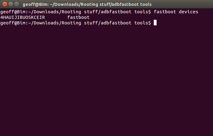

Ok Dan, so please confirm for me that when you type "fastboot devices" into your terminal from the adb tools location, that you see your device...I am gmt +2, so it's 09h10am here.
Pics attached: the terminal detecting your phone as a fastboot device, then fyi your phone is fastboot mode. We need to confirm that you have correectly accessed your phone via adb tools - you should see something similar to "4HAUIJIBUOSKCEIR fastboot". If nothing, your TWRP image will not be installed correctly.
One question: when you try to boot to TWRP, does it default to the MIUI recovery? Or what happens after you wait with the button depressed? Do you feel the vibration?
Let's double-check that you are correctly prepped on your phone. If your phone is not installed with TWRP as I described, you will not be able to root it. TWRP manager is an additional binary gui for using TWRP on a rooted phone, so don't sweat that.

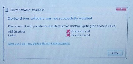

Hi Gelopa
In my terminal(attached screenshot)
Also for some reason I see that drivers are not properly installed for this phone(attaching screenshot). I tried installing universal ADB drivers as my phone was not being recognized.
I wait with the volume up depressed it just vibrates every 15-20 seconds I see the little MI icon in the middle and nothin for the next 15-20 secs, after 1 0r 2 min I release the vol up button MIUI starts automatically.

Hi Dan
So, your phone is prepped properly for use with adb tools. Suggestion: check when you unzipped the TWRP img, it was called "recovery.IMG" and not something else.
As you are in Windows, I can't speak to the specific command, but it looks like you have installed the image correctly.
When you fastboot rebooted, did you return the phone to power off, before trying to boot into recovery?
Did you hold in vol up first, then power, then release power first after you felt a vibration? This process is tricky to describe but easy once you get the hang of it. You don't mention the power button above.
The driver issue you show, I assume, are normal Windows attempts to report; adb is the universal access, as long as you have a suitable one for your phone model Hermes.
Try a different TWRP or CWM image if necessary, but it looks from what you have given me that it should be OK. You definitely used the exact files that I mentioned?
You have progressed, as now you just need to get into recovery. Before you tried installing the fastboot tools, this would have taken you to the stock MIUI recovery. Now you have written the TWRP image, you should be taken there. I understand your frustration, but I can't physically come and try to boot you into recovery, which would help me a lot in advising.
Can you ask someone else to try to volume up/ power? I think, in spite of what you say, that there may be an issue with your recovery boot routine. Use the tip of the volume up at the top of your phone with your left hand and the power with your right hand.

Now, you can type "fastboot reboot", or just remove the battery - get your phone to power off mode and unplugged from your PC. You are now finished with your PC - everything else happens with the PHONE only - make sure it is charged or plugged in for power.
