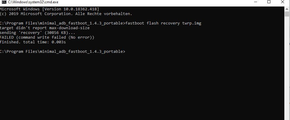

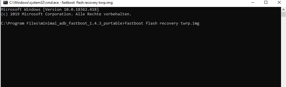

i tried this way....it stucks at this window....i waited more then 30min then restartet my phone and get this message......debugging etc is enabled
Probably you need install ADB drivers, it seems you can not get the device, try "fastboot devices" command and you have to see a line with letters and numbers
Quick search gave, that it might be a problem with usb 3.0 :) But it was a year ago :) Try to install latest version of fastboot and install full adb not minimal.

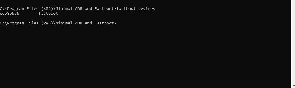

its listed....

Strange thing is i never had Problems to Update to latest Beta in the past....
