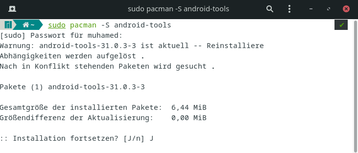

First of all we need adb and fastboot. We will get all what we need over android-tools:
Arch Based distros (Manjaro, EndeavourOS, etc.)
sudo pacman -S android-tools

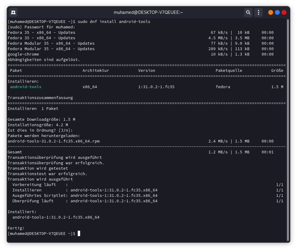

RPM based distros (Fedora, RedHat, Opensuse, etc.)
sudo dnf install android-tools

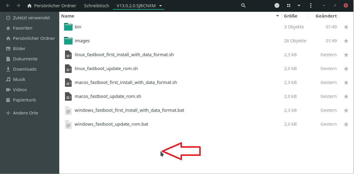

Download the ROM -> extract -> right click (empty space in folder) -> open in Terminal

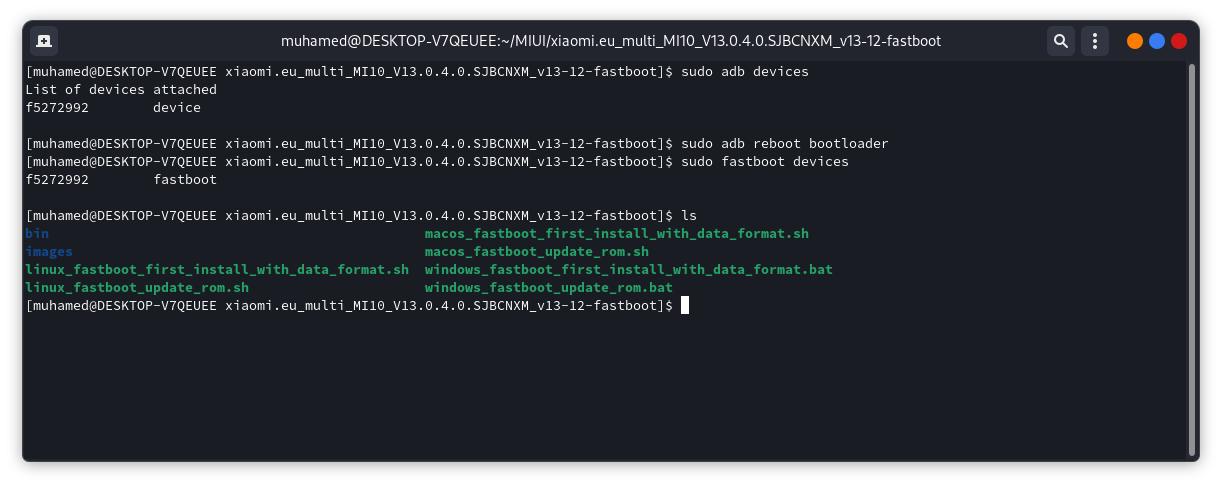

1. Connect the phone with USB cable
2. run -> adb devices
3. a windows will pop up on your Xiaomi smartphone -> press yes/ok and "never forget"
4. run -> adb reboot bootloader -> wait few seconds, your phone will reboot in fastboot mode
5. run -> fastboot devices -> you need to see a number (if not switch USB port/cable)
6. with -> ls -> check if u see the firmware files (if not you are in wrong folder)

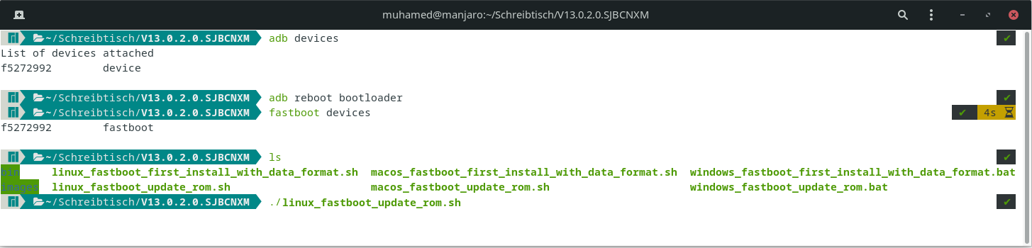

7. now u got 2 options:
fresh install -> ./linux_fastboot_first_install_with_data_format.sh -> will wipe all data and only for first install
update rom -> ./linux_fastboot_update_rom.sh -> will update without wipe

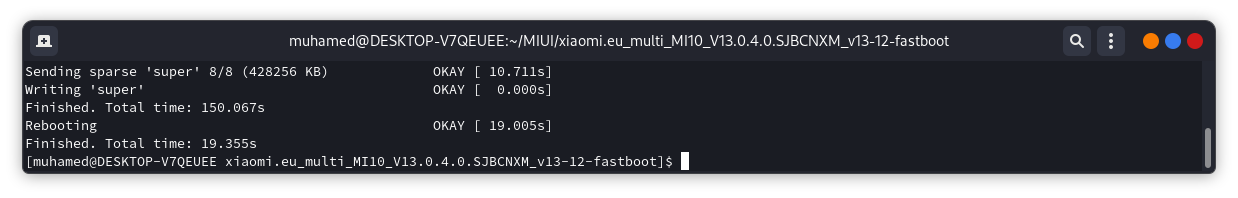

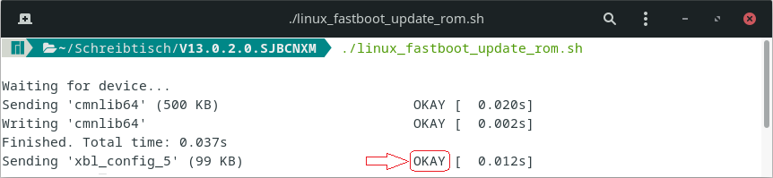

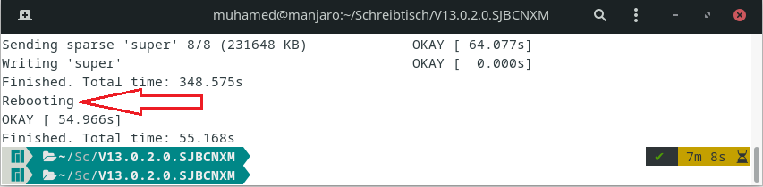

You need to wait untill you see this:
Finished and Rebooting. This will not happen immediately, just wait untill your phone reboot, than u can close the terminal and disconnect USB cable.

Quick update, I also try it on Fedora 35 (36 still not available)
It's working with USB 3.0 port and even on Type C USB 3.2 Gen 2 port but you need the sudo before any command.
This is just to take away the fear...

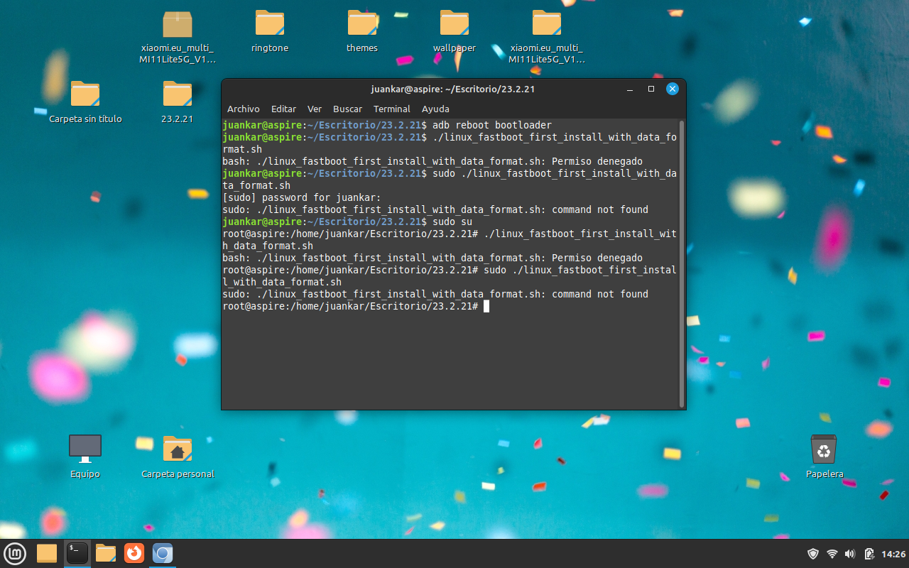

I'll try one more time before posting my question... sorry, I don't know how to remove it.
I have this error:
sudo: ./linux_fastboot_update_rom.sh: command not found
If I use sudo sh {comand} I have the next error:
bin/linux/fastboot cannot be executed.
Can someone help me please?
I have this error:

I have this error:
For thos command you don't need sudo and never type sudo:
Like you see in the screenshot you don't need nothing before ./linux_fastbo...
Same error using Linux Mint LMDE
