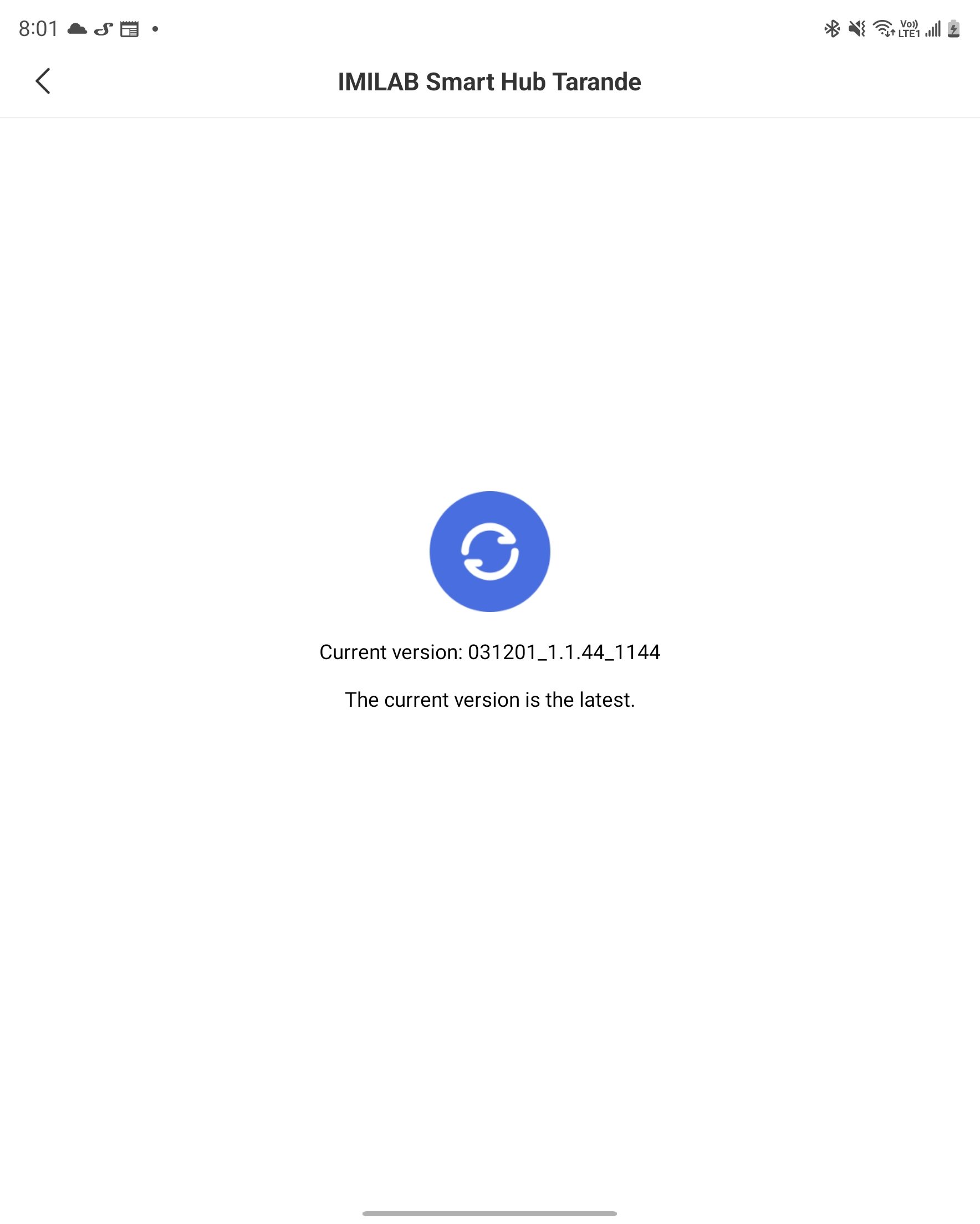

Updated firmware to the latest version. Restarted device and open network reappeared again..
one more finding. with this latest update. Open network remains unavailable until I try to connect smart hub to wifi. After connection fails then this open network appears. i had to restart hub for two times, now open network not available, for last 2 hours at least.
