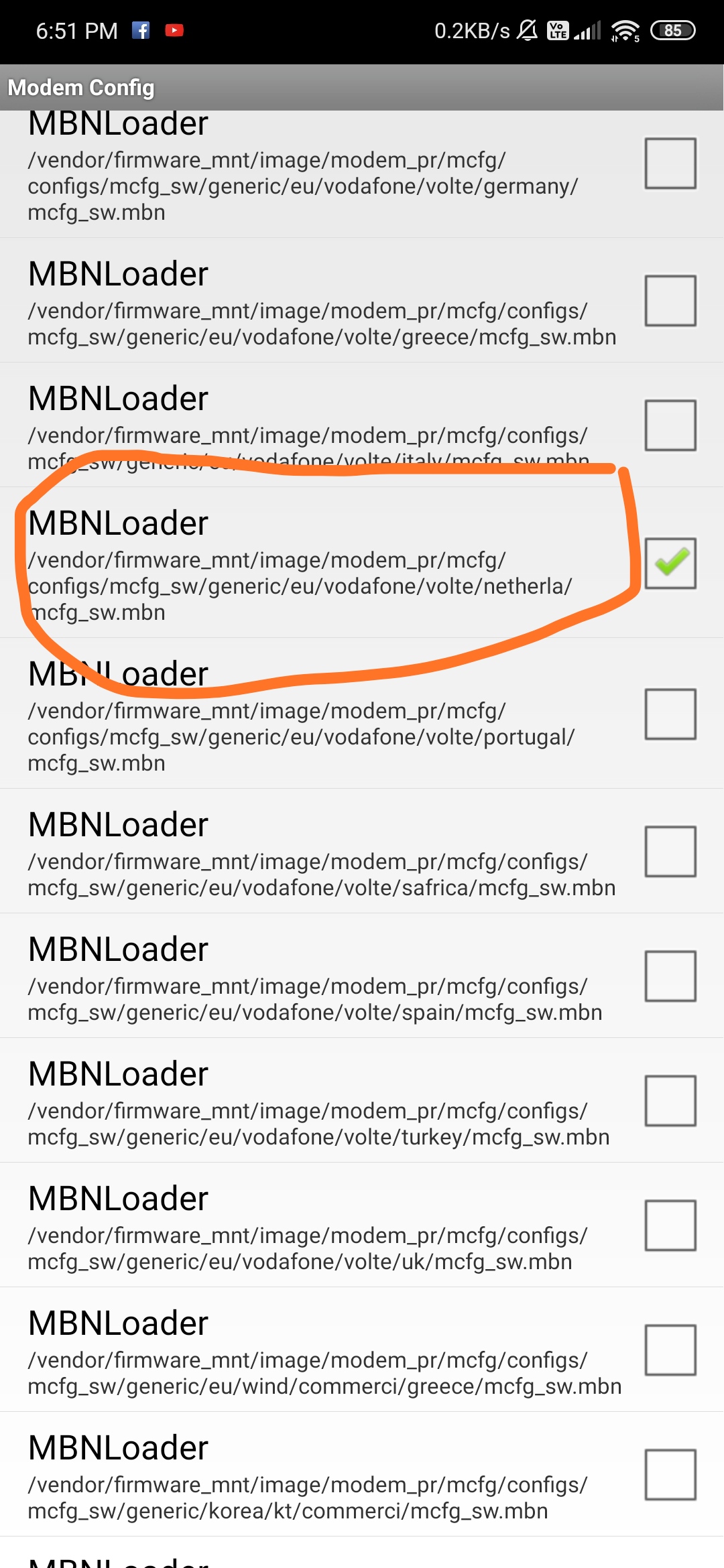

1- Download Activity Manager
2- Open the app & go to Activity list tap
3- Search for ( Modem Config )
4- Tick on the one that have ( vodafone/volte/netherla ) in its path
I used to have this issue for more than 3 months and I have tried all the available solutions
and only this one worked for me
