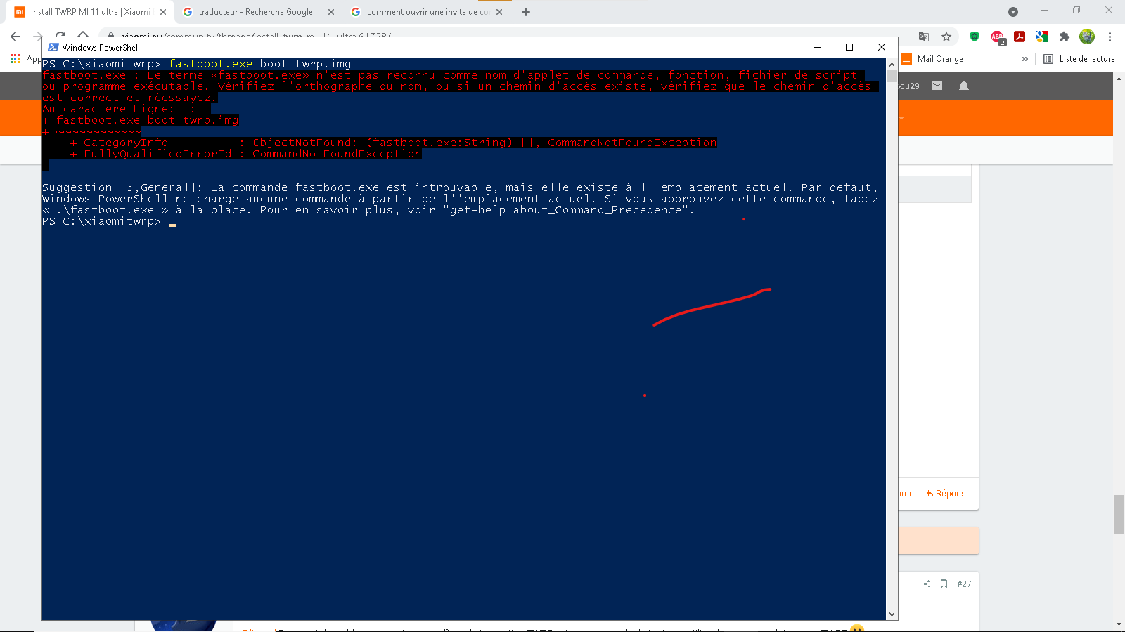

I wanted to upload xiaomi.eu via TWRP but something went wrong. from TWRP position I cannot wipe my memory
The screen you show is not the one you see right after entering twrp...
Try again.

@Siscodu29 "C:\Users\Pc salon\Desktop" =/= "C:\adb", use cd C:\adb to change your current location in command-line prompt.

it's easy for you, black magic for me .......... I do not want to damage the phone ...

You need to open the cmd in your adb directory. In your adb folder press and hold shift button on keyboard then right click on mouse and select open a cmd prompt here

You just reboot system, why did you boot into twrp if you don't want to install a rom?
