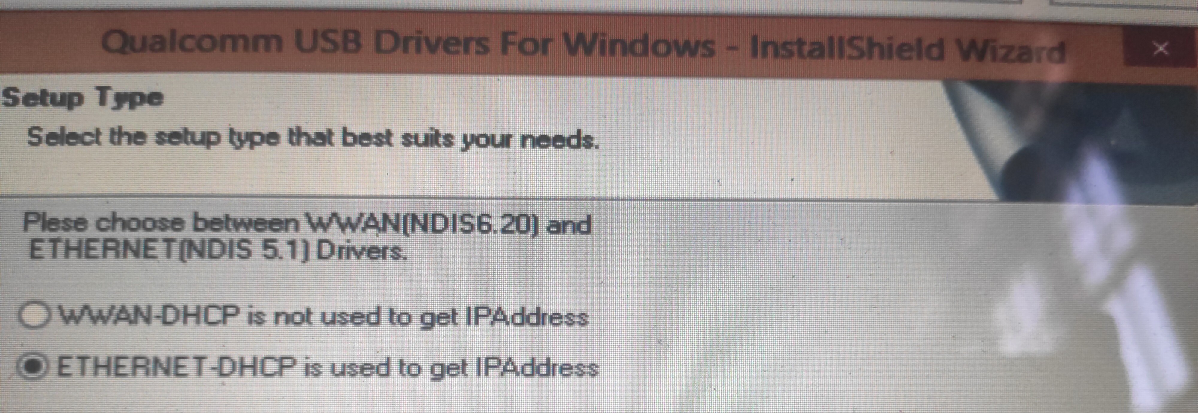

Sir i have download this and connect my phone to my PC but it doesn't show that anything is connect, my bro told that i should install Mi 9 se driver, what should I do sir? Is my cable not xiaomi's? I download qualcomm usb drivers online, is this right sir? If yes then what should I choose?[Download] ADB Installer v1.4.3 - Drivers, ADB and Fastboot Tools
