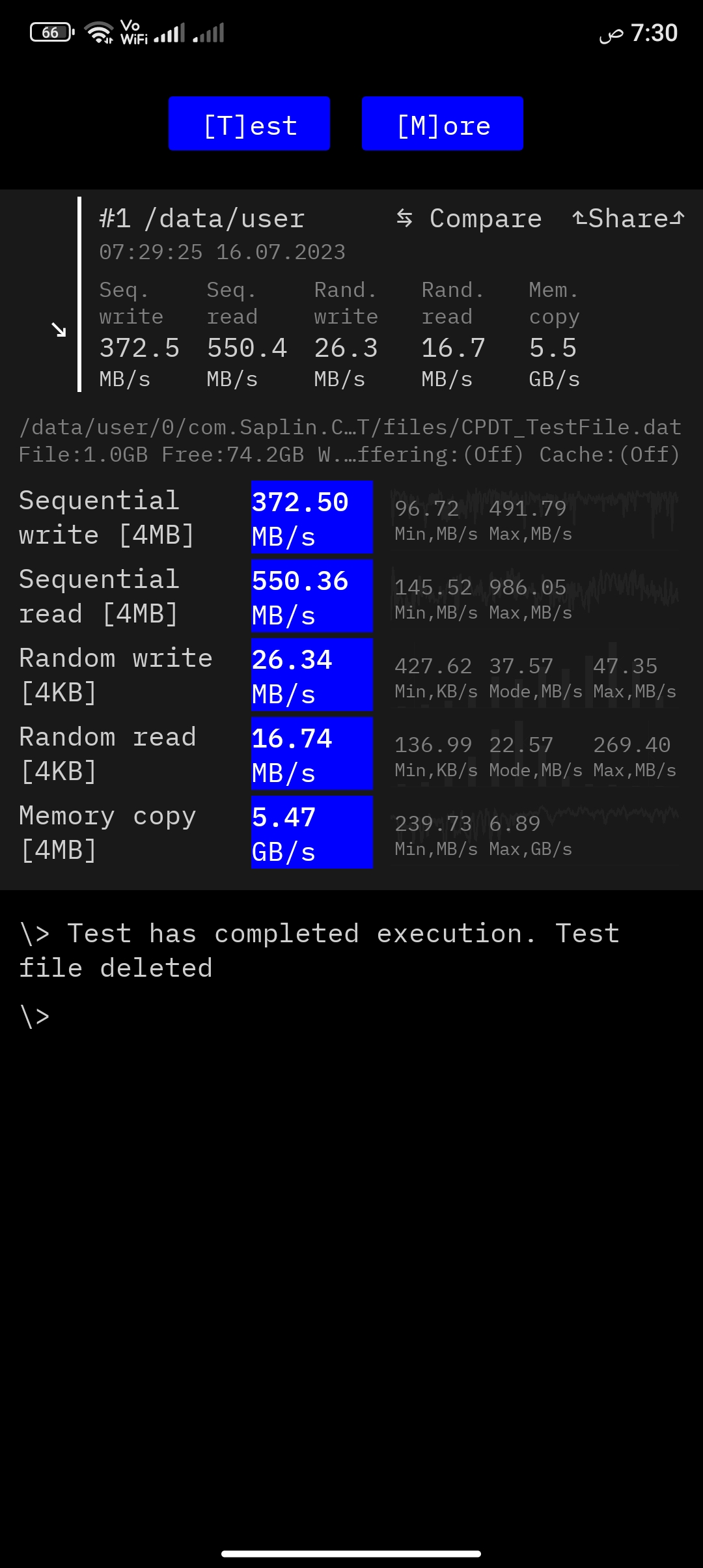

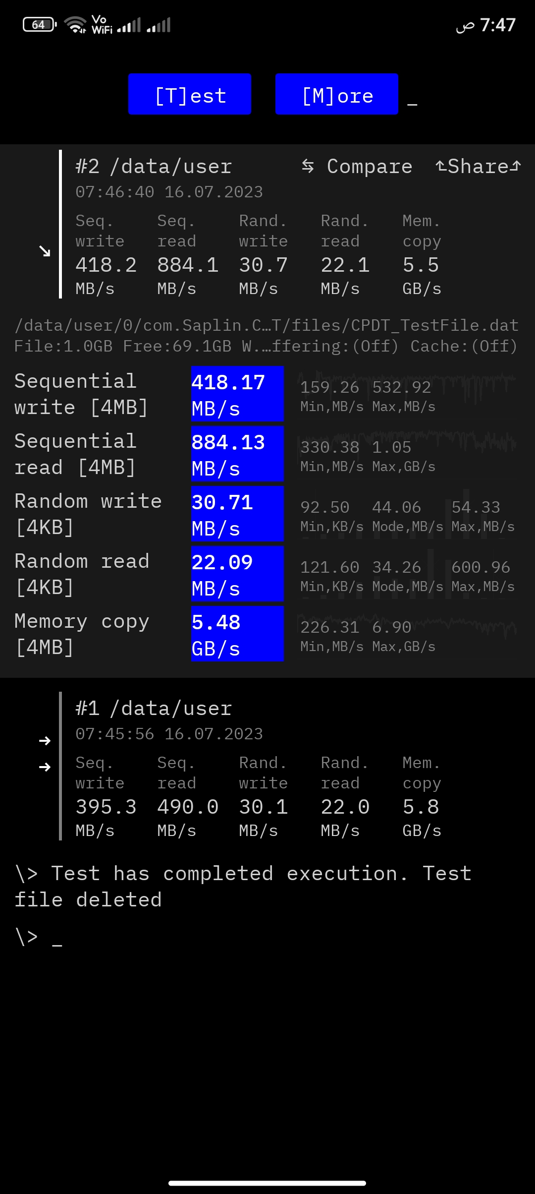

Here is an odd situation where ram+ actually improves performance and turning it off reduce it
Poco M5 MIUI 14
128GB 6GB
Poco M5 MIUI 14
128GB 6GB
Something else was running in the background during your disabled test because it makes zero sense that using a feature that creates more reads and writes to the nand flash would actually increase a nand flash read and write benchmark performance. Logic dictates that your test is a fluke/invalid.
I did restart the phone and repeated the test 3 times for each. every time the 5GB has better read/write speed!

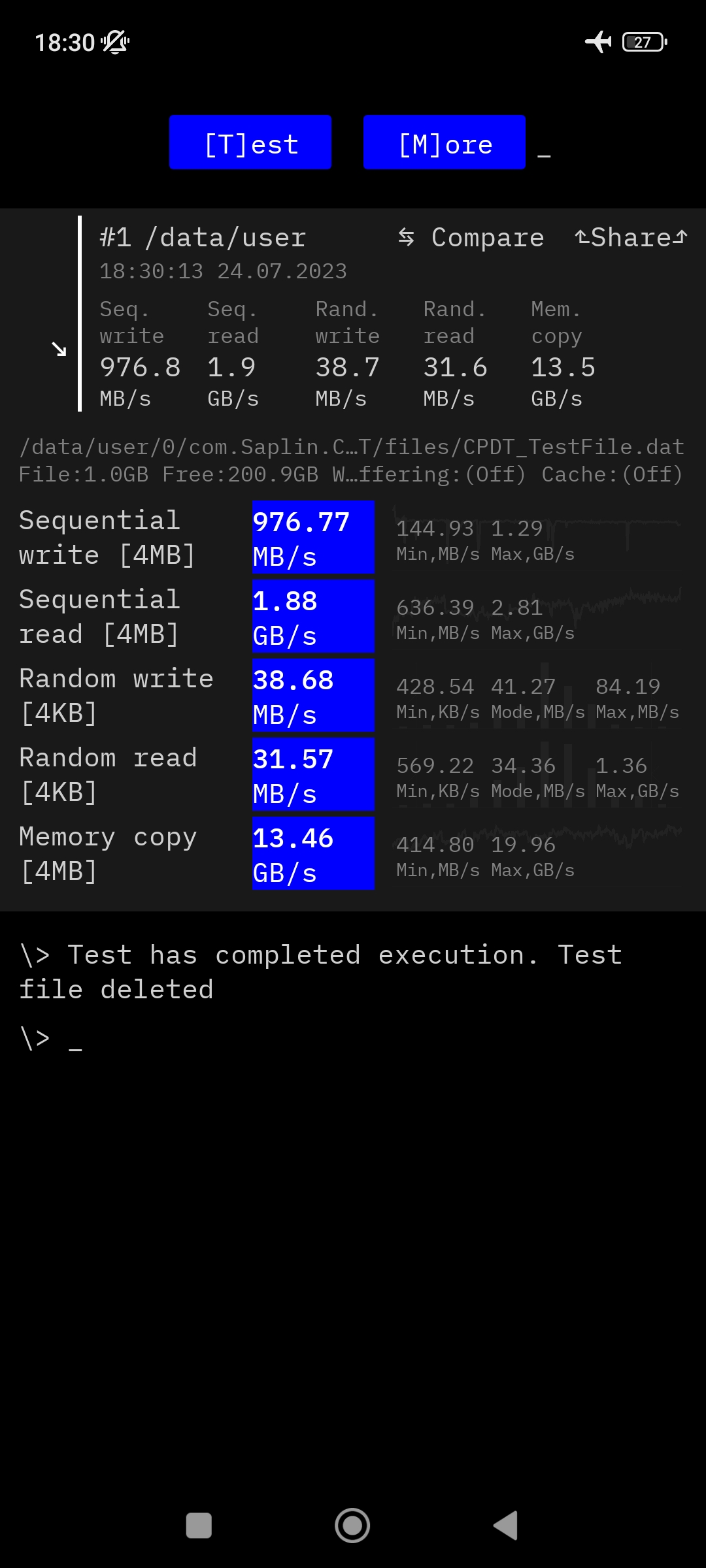

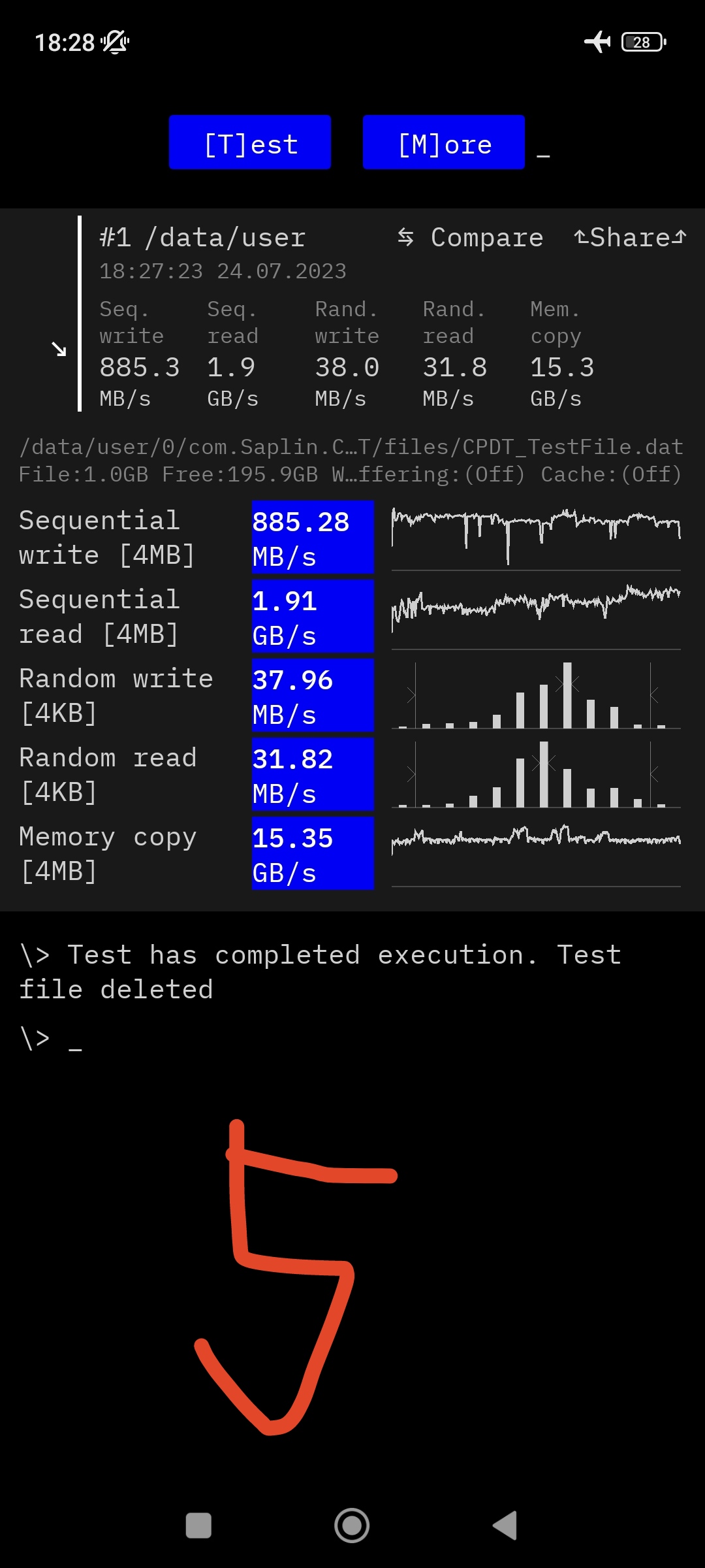

Any suggestions to make it more accurate?
Phone: Xiaomi 13 Global
Rom: MIUI 14 Global, debloated
Reactions: notsosus
Looking at the results it's kinda clear that the performance is the same in both on and off benchmarks. I guess benchmark apps are not really a good tool to check if it's bad or good as the memory extension gets used after a certain part of RAM has been used.
