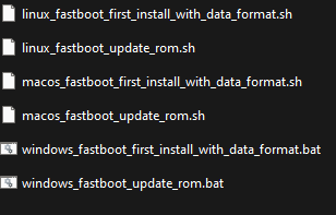

You have installed a TWRP for Android 13 on an A12 system.
Use the bat(first install or update) file included in the extracted zip folder.
Ok. I was pretty sure that I was already running running miui13 and it was the same image leftover in the root directory of my phone that i reflashed to fix the failed miui14 install.. Is that not installing TWRP on an A13 system? For .bat file. I can't see any .bat file in the miui14 rom.zip? Is it because it is hybrid or something? Thanks
There are always 3 lines in red when flashing with the TWRP, it's a bug.
Precisely because it is a hybrid rom which contains the bat files.

Use the bat file to update to MIUI14.
"no operating system installed" is not part of the bug but a user from another device reported this and rebooting to the system worked.

c:\test>windows_fastboot_update_rom.bat 'windows_fastboot_update_rom.bat' is not recognized as an internal or external command, operable program or batch file.
may be a problem on your pc, try as administrator or install platform tools and put the contents of the rom folder in the platform tools folder.
So I downloaded the rom again (from here https://sourceforge.net/projects/xi...files/xiaomi.eu/MIUI-STABLE-RELEASES/MIUIv14/ )
The problem is that there is 2 roms for mi 11 ultra on the page.
The one I was trying (xiaomi.eu_multi_MI11Pro_MI11Ultra_V14.0.6.0.TKACNXM_v14-13) had no batch files in it. Maybe a recovery zip or an error I don't know.
As soon as I downloaded xiaomi.eu_multi_MI11Pro_MI11Ultra_V14.0.9.0.TKACNXM_v14-13 it was done successfully in a couple of minutes.
