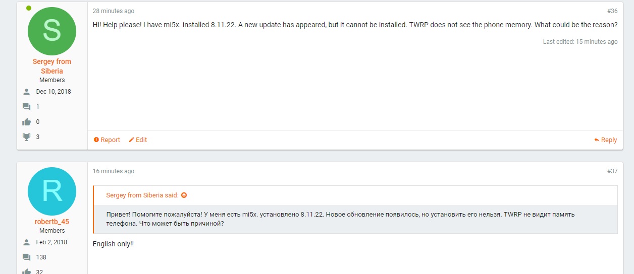

Hi! Help please! I have mi5x. installed 8.11.22. A new update has appeared, but it cannot be installed. TWRP does not see the phone memory. What could be the reason?
Привет! Помогите пожалуйста! У меня есть mi5x. установлено 8.11.22. Новое обновление появилось, но установить его нельзя. TWRP не видит память телефона. Что может быть причиной?
English only!!
This will end up with your Data Loss so Backup Them.
Format data in TWRP This where you have to type YES to confirm If it ends with some red errors go back to main TWRP menu Reeboot To Recovery and do it again ->Format data. Now it should finish without errors and you storage should be visible again.
TWRP can not mount the phone memory. I can't make a backup and I can't make a wipe.
Can it be a matter of switching from the 7 version of Android to 8? twrp 3.2.1-0 worked without complaints on Android 7.1 Update from 7.1 to 8.1 (8.11.22) passed without any problems. Now there is another update (8.12.6) and my twrp can not update the system.
