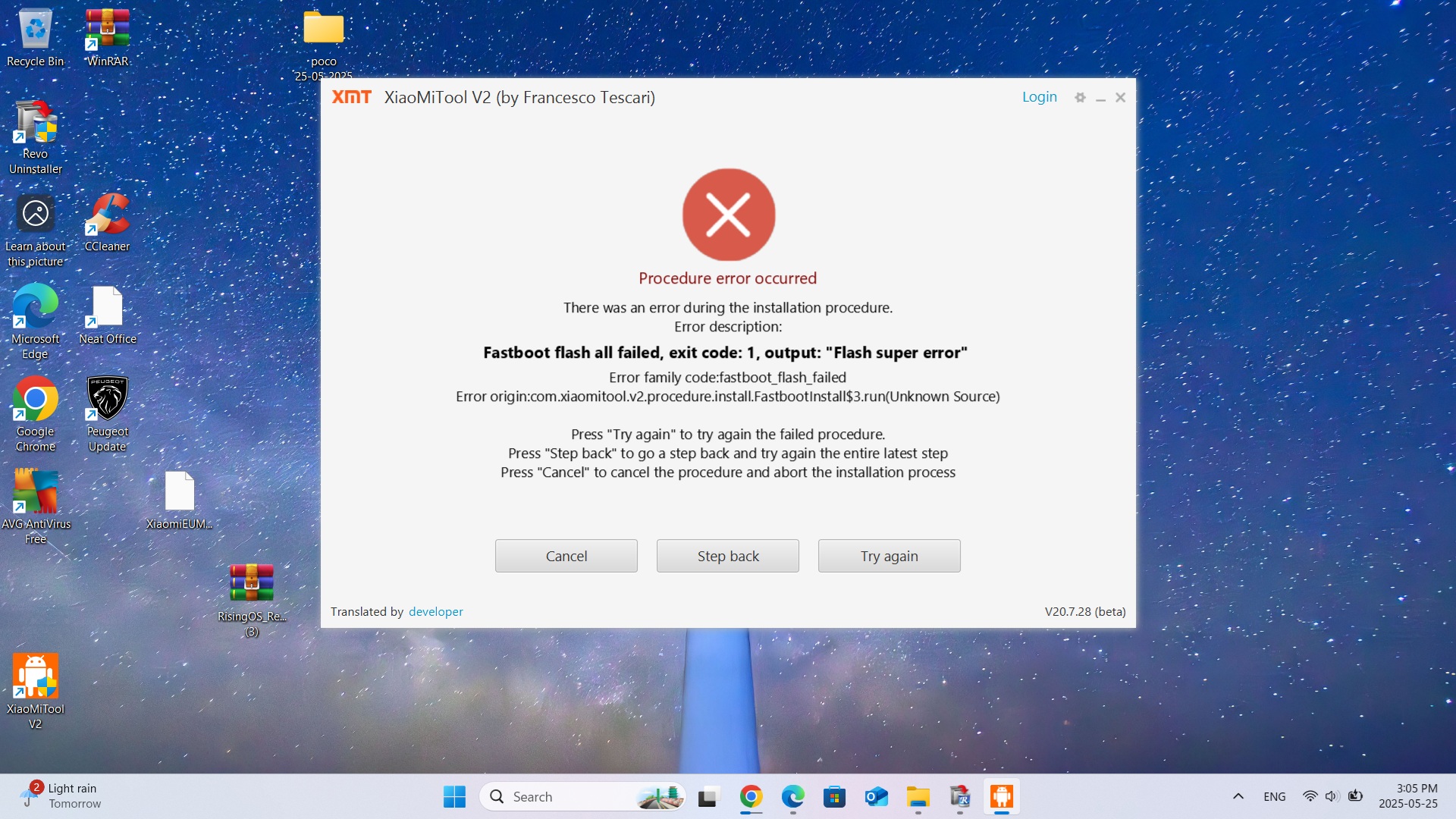

Thanks,I have tried everything, after i install the eu.rom I can not install the twrp recover or and official room.

Of course you can't.
If you have a xiaomi.eu ROM installed, install the update from the link below.
ROM for Poco F6 Pro (vermeer): xiaomi.eu_VERMEER_OS2.0.108.0.VNKCNXM_15.zip
Then install this application via the system app "Files".
