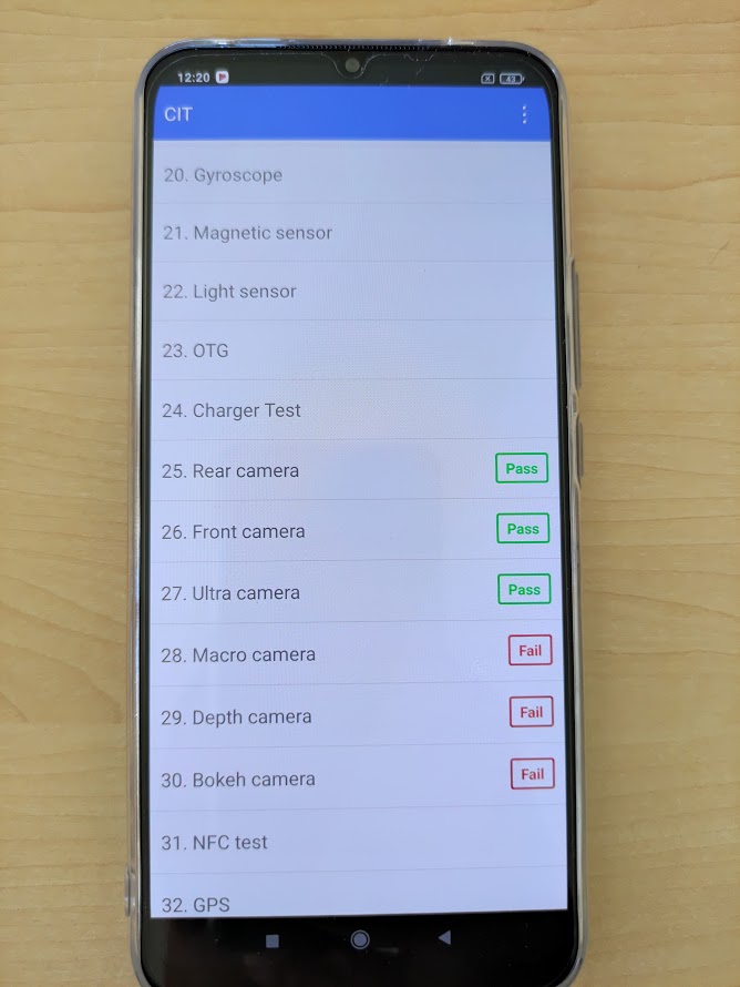

you can use service test mode to check your camera hardware has problem or not
click setting --> my device --> all spec -->click kernel version 5 times
or clear data and cache about camera app

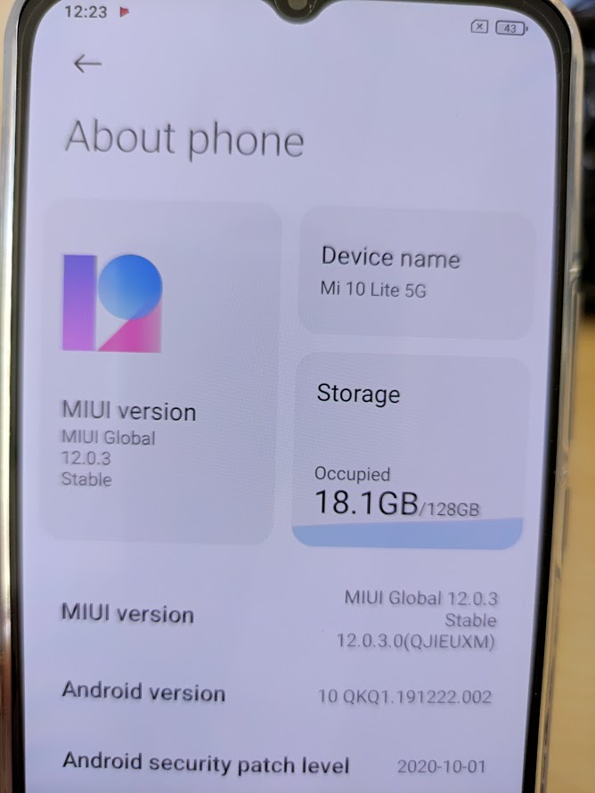

Thanks did the test, and the main camera passes, as well as ultra wide, it is a the macro and depth that fail. Obviously there is no depth on the lite zoom and the macro is maybe a different type in this one, not sure. I see the firmware version installed on the device is v12.0.3.0.QJIEUXM which I believe is Monet and mine is definitely the lite zoom as it says 50x on the camera at the back.
Images attached

check your phone box is black or kid screen
if black is mi 10 lite 5G
if kid screen is mi 10 youth ( lite zoom )
