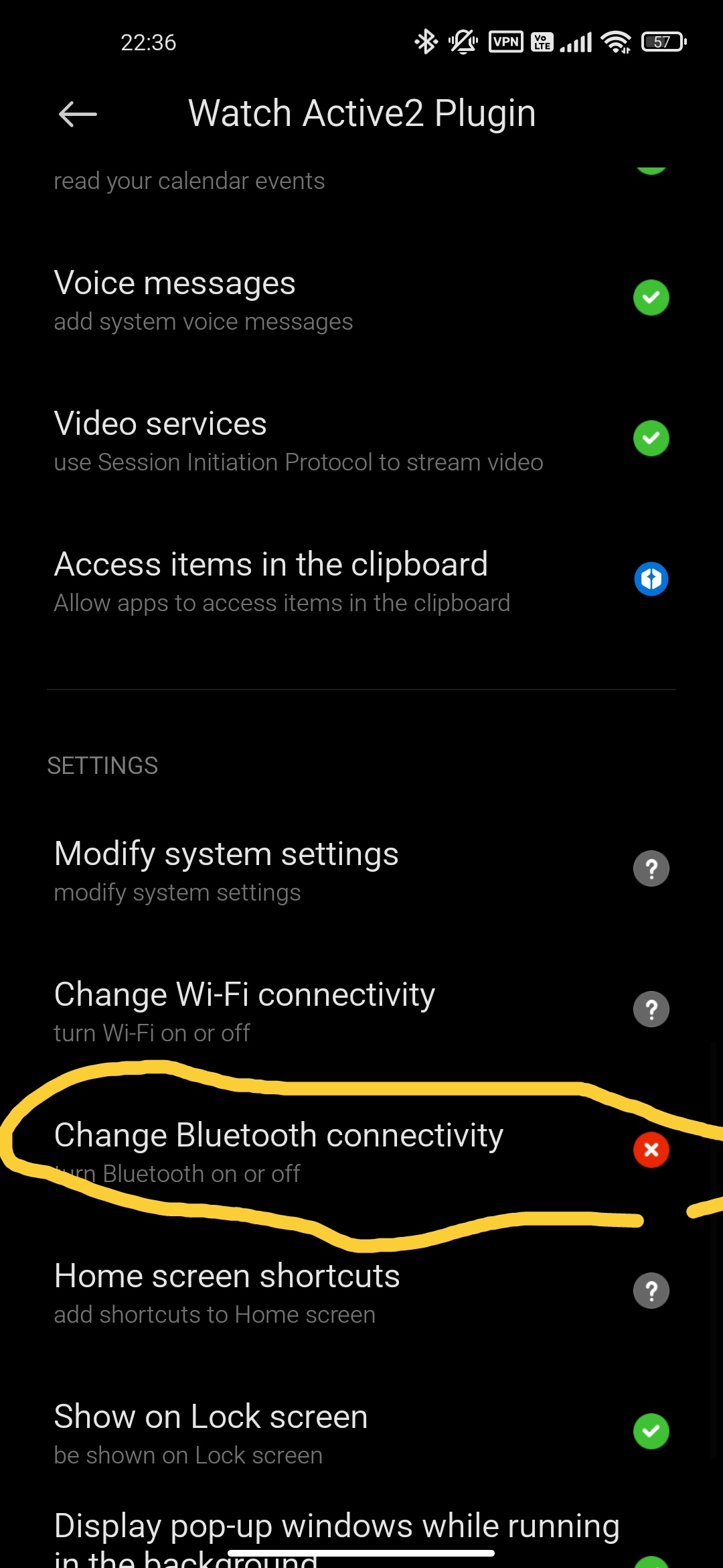

update The solution that worked for me was not to give permission galaxy watch plugin App To change Bluetooth Activities. I use Galaxy watch active2. After I turn off the permission the sound always comes from the cell phone and not directly from the watch.
