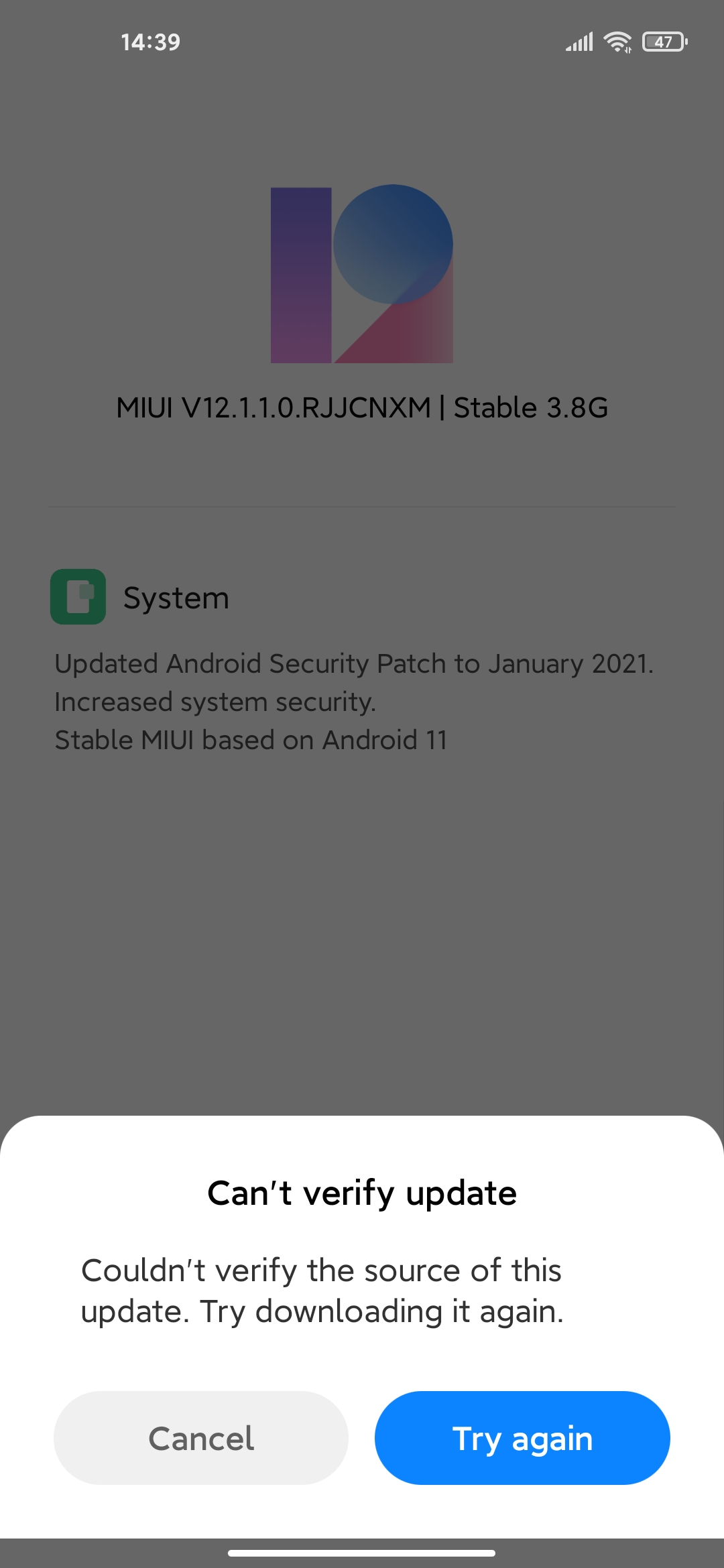

Hi Guys, I own a Mi10 ultra and when i try to update to the latest firmware I get a "cannot verify the source" message. See attached. Does anyone else have the same problem? Any solution you can suggest?

You are trying update a Chinese ROM from outside China. Use a VPN with a Chinese server to fake that you are there and it will download. It's them trying to restrict the phones use outside the intended area.

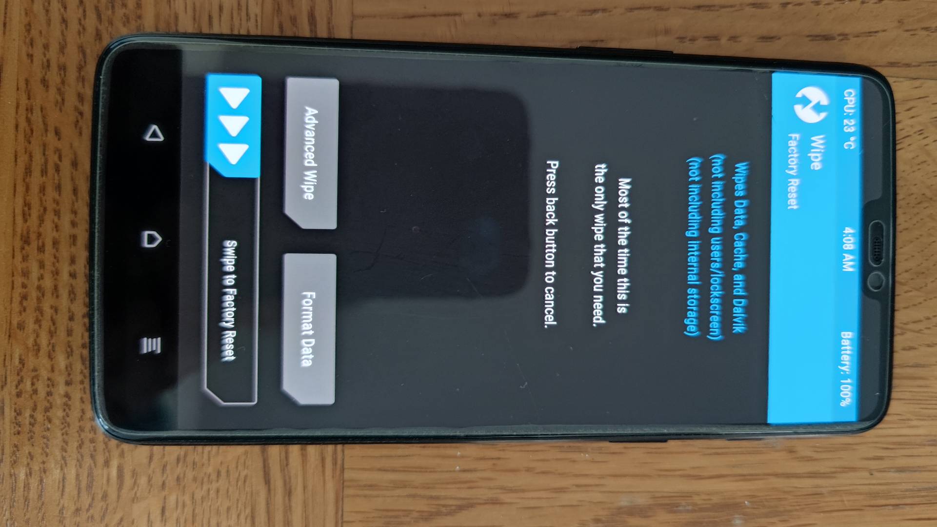

What is the difference between formatting data and just wiping it? How do you do each?

Data wipe only wipes your cache and dalvik, you do this every update, format clears everything back to unused phone where it needs to be set up.
You must format in branch changes as the different ROM branches may use different partition sizes and old data can remain and corrupt the new layout, hence things not working properly. See attached screenshot for format in twrp.

When you update, it is the option in twrp that appears after the update is done. You just swipe to clear dalvik and cache. If you go in to the wipe menu, you will find the format button and you have to type yes to confirm the action.
Thanks a lot mate that seemed to be the issue.
