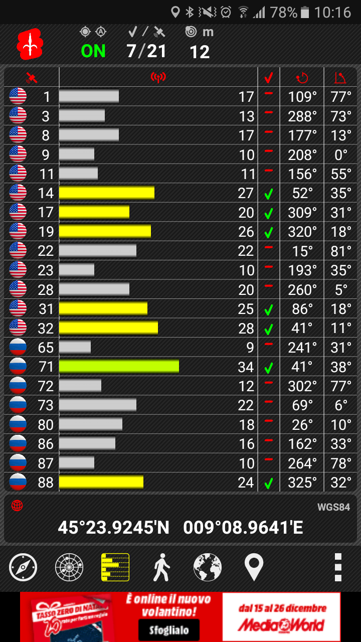

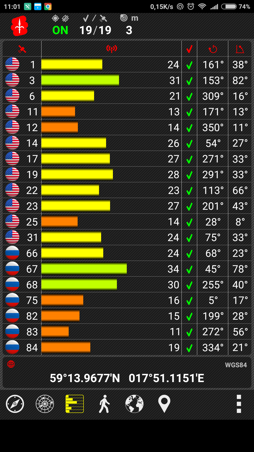

I have also a cheaper phone (samsung galaxy a3 2016) that works much better than mis5s plus.

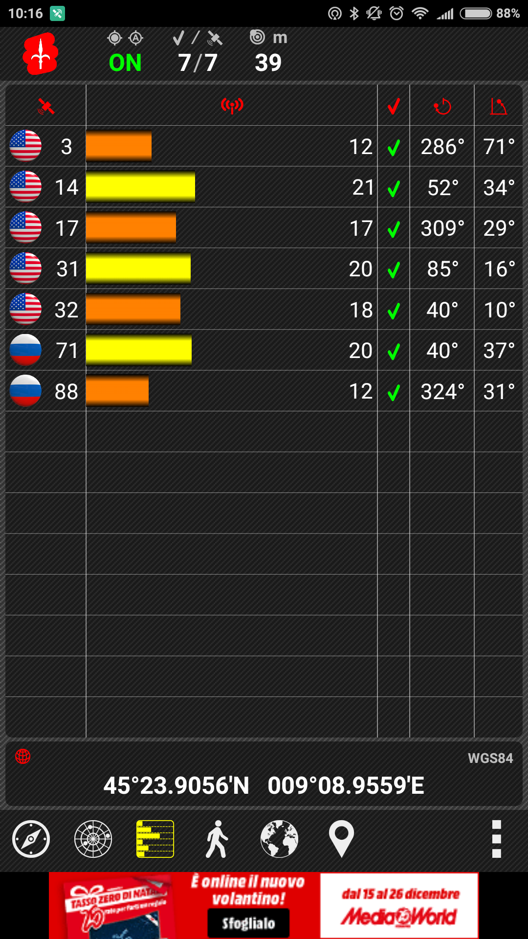

Mi5s Plus loose the signal and position and see less satellite than galaxy a3.
Below screenshot from two devices.
xiaomi mi5s Plus
galaxy a3 (2016)

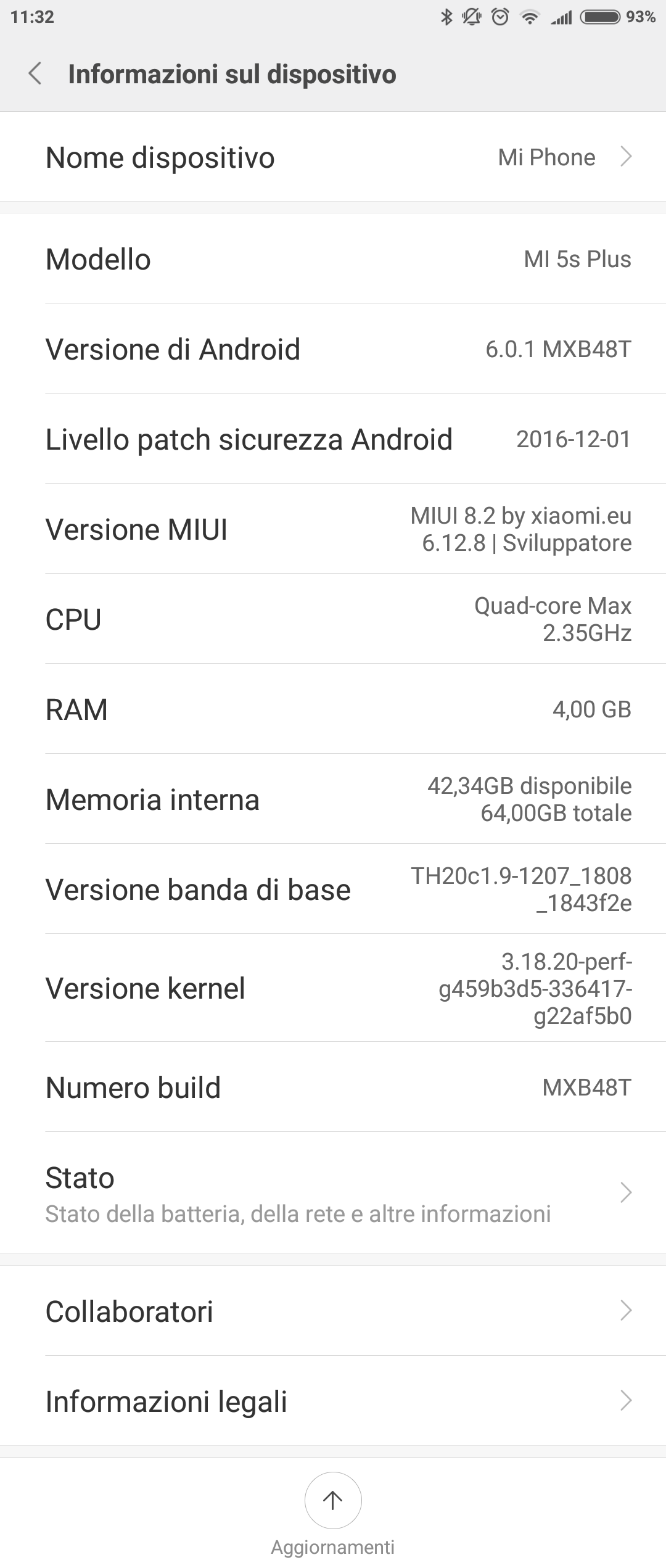

nevermind, seems that my gps is much better with version 6.12.8, 20 out of 20 satelites under less than 10 seconds.
im about to upgrade to latest weekly, 6.12.22.
Im guessing my issues have been solved by sw update.
I have the same issue on the same phone.
I'm on the 6.12.8 too. The problem was not present before.
I've updated to 6.12.22, issue still remain.

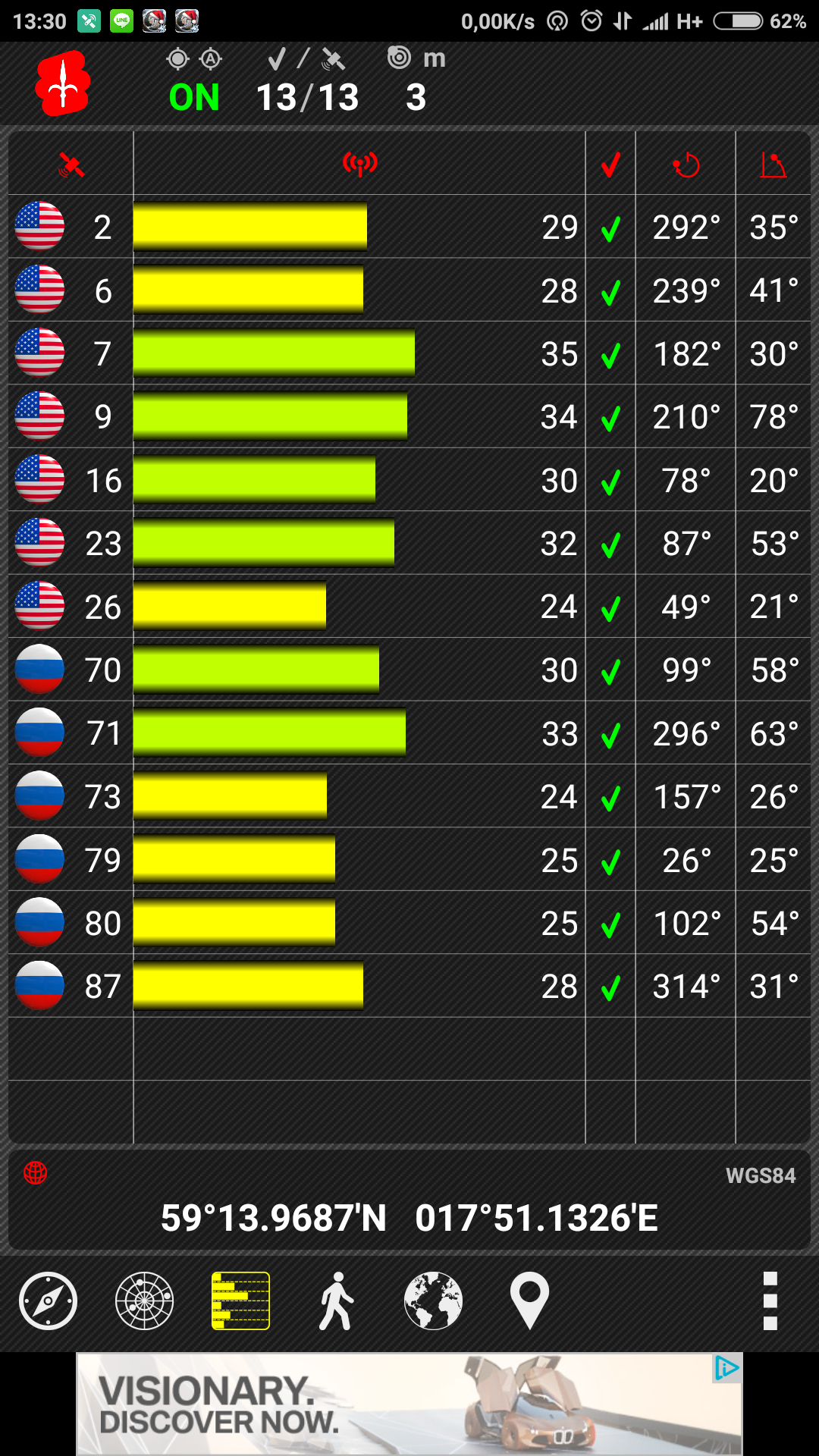

2 pictures uploaded v. 08 had more satelitws than V.22 but less signal.

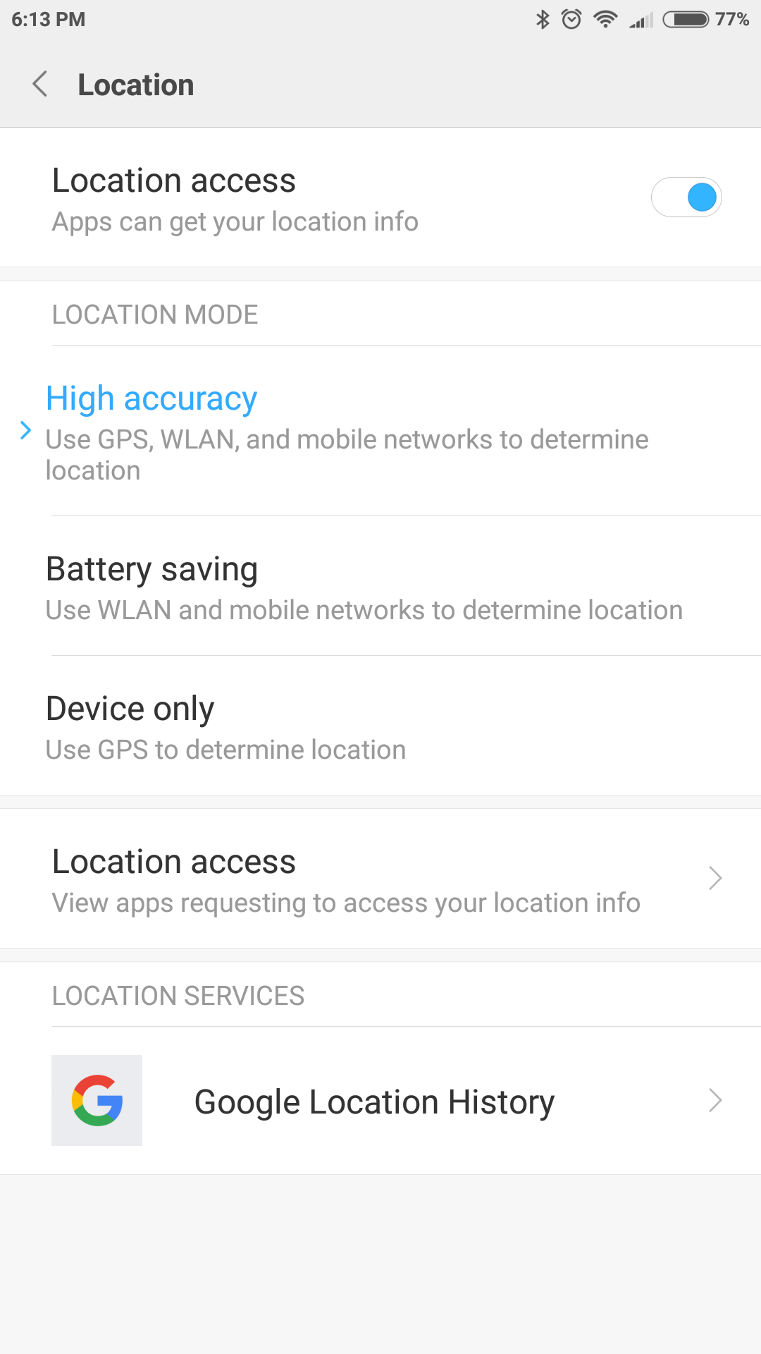

GPS is setting on High accurancy.
If I turn off GPS using quick tiles GPS goes over to battery saver.
And then If I turn on GPS using quick tiles GPS goes to High accurancy.
I wonder if it's a software issue.
Before switching to xiaomi.eu ROM I didn't remember this GPS issue.
I'll do a test installing Golbal Developer ROM in the next days.
I'll let you know the results.
