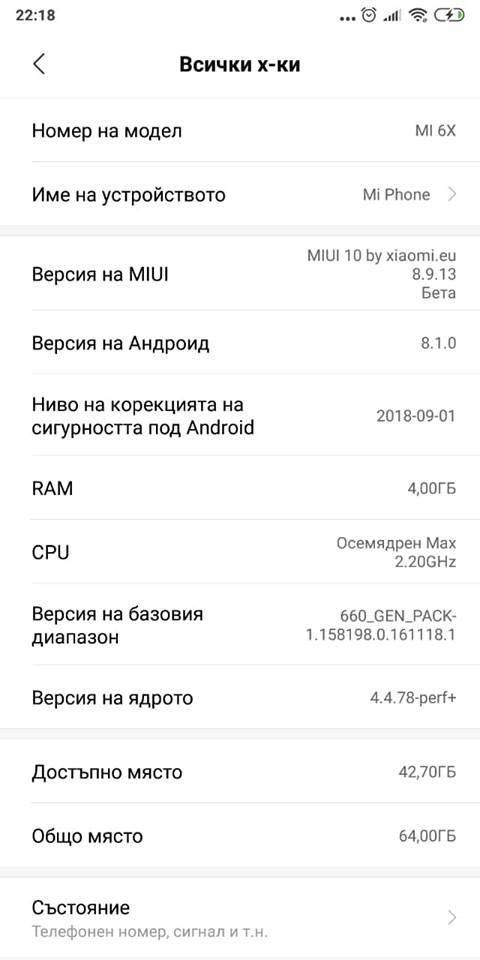

if you flash mi 6x with xiaomi.eu rom but flash mi a2 baseband you get better reception and battery performance
just take modem.img from jasmine (mi a2) rom and flash it via fastboot method
fastboot flash modem modem.img and you got better :)
i hope the amdins will test it and next roms will be already with jasmine modem

1 last question, what difference did you notice after you flashed that modem with the reception ?
better 4g and before on some places i can not make decent phone call now there is no problem at all
the battery last at least 3-4 hours more and i have no complains durings call and using 4g
try it if you not like it you can flash back original modem with the same command
