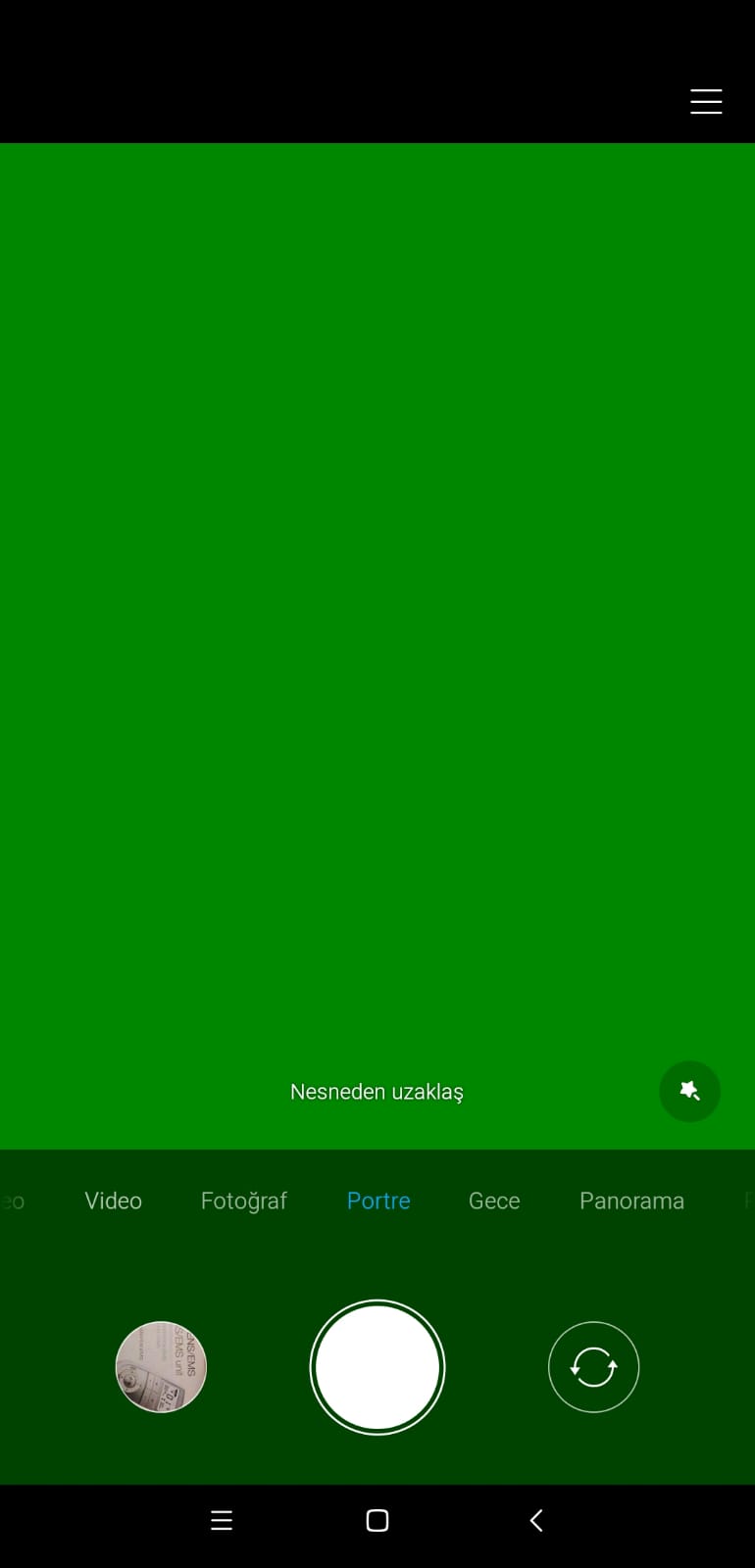

green screen error in portrait mode. Please help to mi 8 se users.
MI 8 SE cihazımdan Tapatalk kullanılarak gönderildi
Türk mi 8se users When the modem uploads the file, the proximity sensor does not work and the green screen is displayed in portrait mode.
Same problem with Mi8SE

Hi again ,
I just installed clean install ( before i erased date / wipe data and system cashe also )
After install Camera work properly ( also portrait mode )
Than install Turkish modem file ( modem_MI8SE_9.5.16.zip ) SIM cards work properly both but
Camera Portrait Mode didn't work like before :(
SIM cards doesn't work without flashing old modem?
Yes , SIM Cards doesn't work . After flashing old modem file both SIM work properly

öğretmenim, şimdi ab 20.1.2 kullanıyorum ve modem dosyası portre modunda yeşil ekran hatasına neden oldu ve yakınlık sensörünü çalışmıyor.
Do not answer writing into Google translate tool because it revert to your native language.
Same errors on my Mi8SE
( Installed Miui 11 | 20.1.2 weekly with old modem file)
After flash modem file:
1) portrait mode doesn't work on camera
2) proximity sensor doesn't work
Also i tested it from device test section. Back both camera fail, proximity section didn't appear any value ( shows zero)
*** Want to mention that these errors started to make in the last 2-3 versions of updates.
20.1.2 weekly
9.12.26 weekly
9.12.19 weekly ( not sure)
Thank you for help ✌️

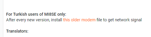

Another Turkish Mİ 8SE user here.
MIUI V11.0.1.QRBCNXM by Xiaomi.eu installed.
> No signal
modem_MI8SE_9.5.16_TWRP installed.
> Carrier signal (Experienced LTE/4G/H/3G/2G/E )
> Proximity sensor doesn't work properly. (CIT doesn't see it, no numbers. While unlocking from standby, a short-timed error of "Don't cover speaker area" shows up sometimes, although not covered)
> Green screen in "Portrait" option in camera app.
File from this link installed: https://forum.miuiturkiye.net/konu/...si-portre-modu-ve-sensor-sorunlari-yok.67978/
> "Portrait" camera works. Proximity still doesn't
