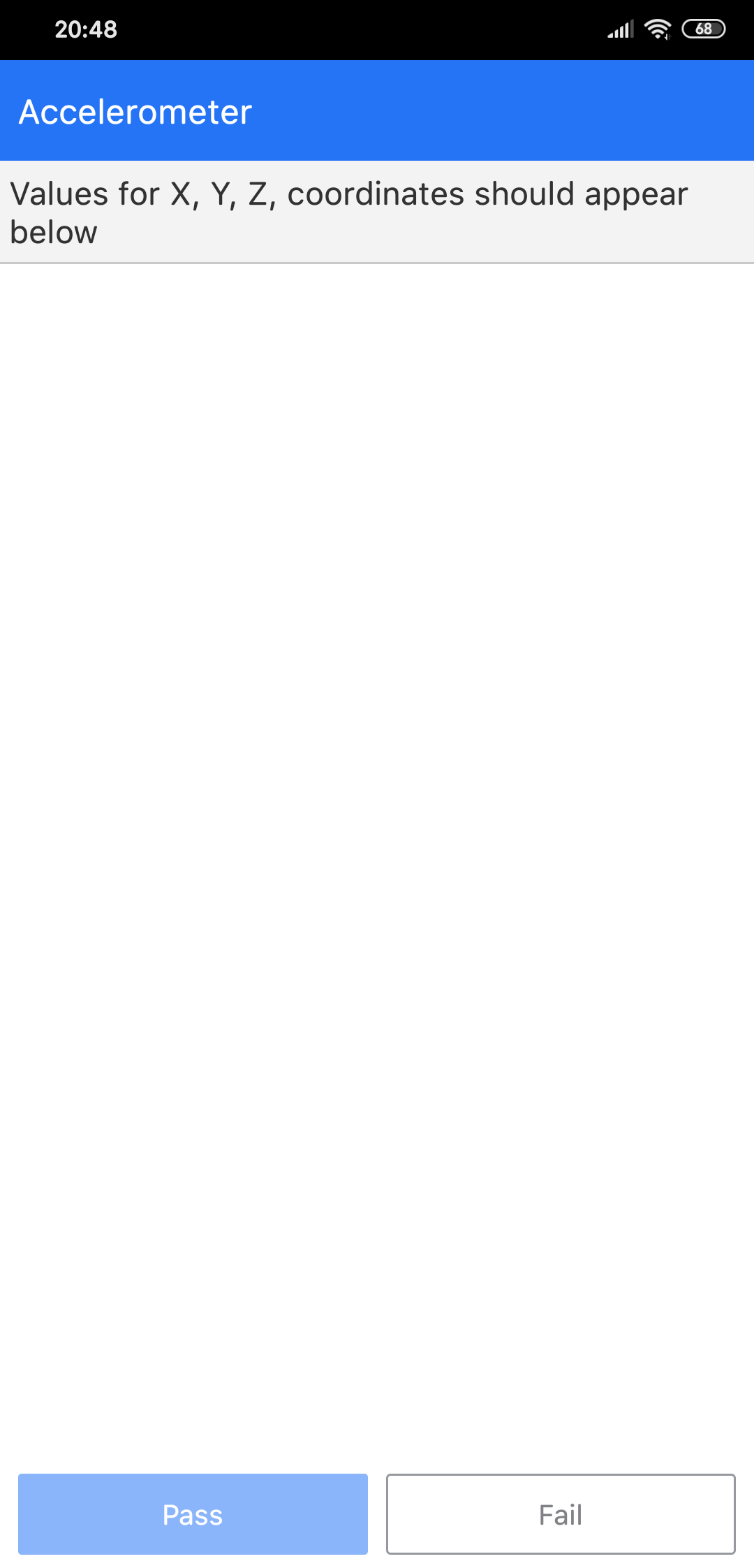

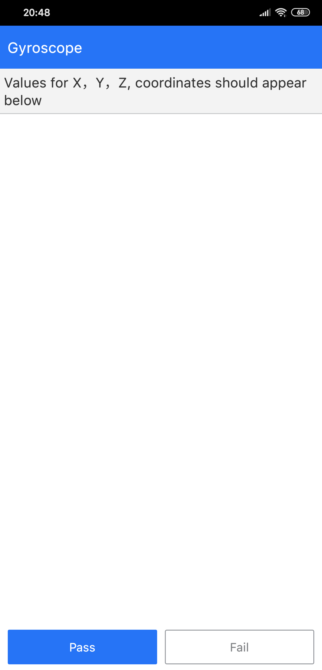

Neither my Accelerometer nor my Gyroscope are functioning at all. What can I do?
A aidenpatrickpgh Members Aug 6, 2018 16 13 Dec 18, 2018 #1 Neither my Accelerometer nor my Gyroscope are functioning at all. What can I do? Attachments Screenshot_2018-12-17-20-48-52-769_com.miui.cit.png 45.3 KB · Views: 418 Screenshot_2018-12-17-20-48-47-539_com.miui.cit.png 43.9 KB · Views: 380
T tekkasit Members Nov 25, 2018 17 15 Dec 18, 2018 #2 Can you try to restart the phone and test again?
A aidenpatrickpgh Members Aug 6, 2018 16 13 Dec 18, 2018 #3 tekkasit said: Can you try to restart the phone and test again? Click to expand... Still doesn't work. I know it's a ROM issue however as I can restart both the Accelerometer and the Gyroscope by opening AIDA64's Sensors menu. The sensors just time out after about five minutes.
B Beastman Members Aug 13, 2018 1 13 Dec 18, 2018 #4 It seems that you delete persist partition. Look at this link Persist recovery
