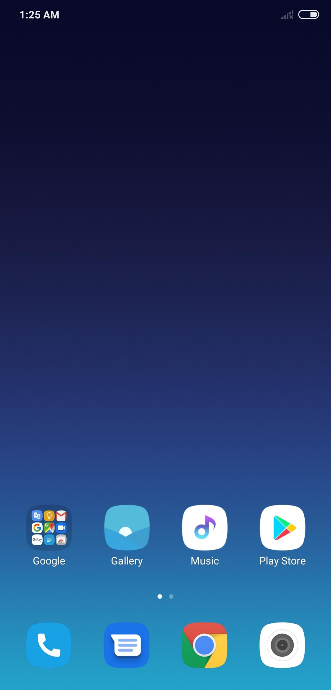

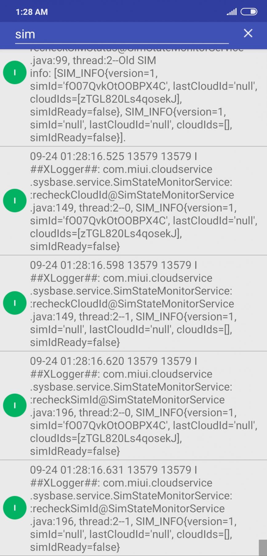

Hey All, kind of a weird situation here.
My Mi 8 (Chinese Ver. 64GB, 6GB Ram) after updating to 9.9.3, now has constant problems/hitches/crashes connecting to Wifi and Data or getting service overall. This happens with Sim in or out of Phone.
I have tried clean flashing both 9.9.3 and latest global using the fastboot method, clean flashing Xiaomi.eu using TWRP, formatting Data, Deleting Data,System,Cache, Boot partitions and Reflashing stock, as well as flashing just the Vendor from 9.9.3 after clean flashing Xiaomi.eu 9.9.3.
I have attached some screenshots (look at status bar) and some logcats of the Searches Modem and Sim
Help?
