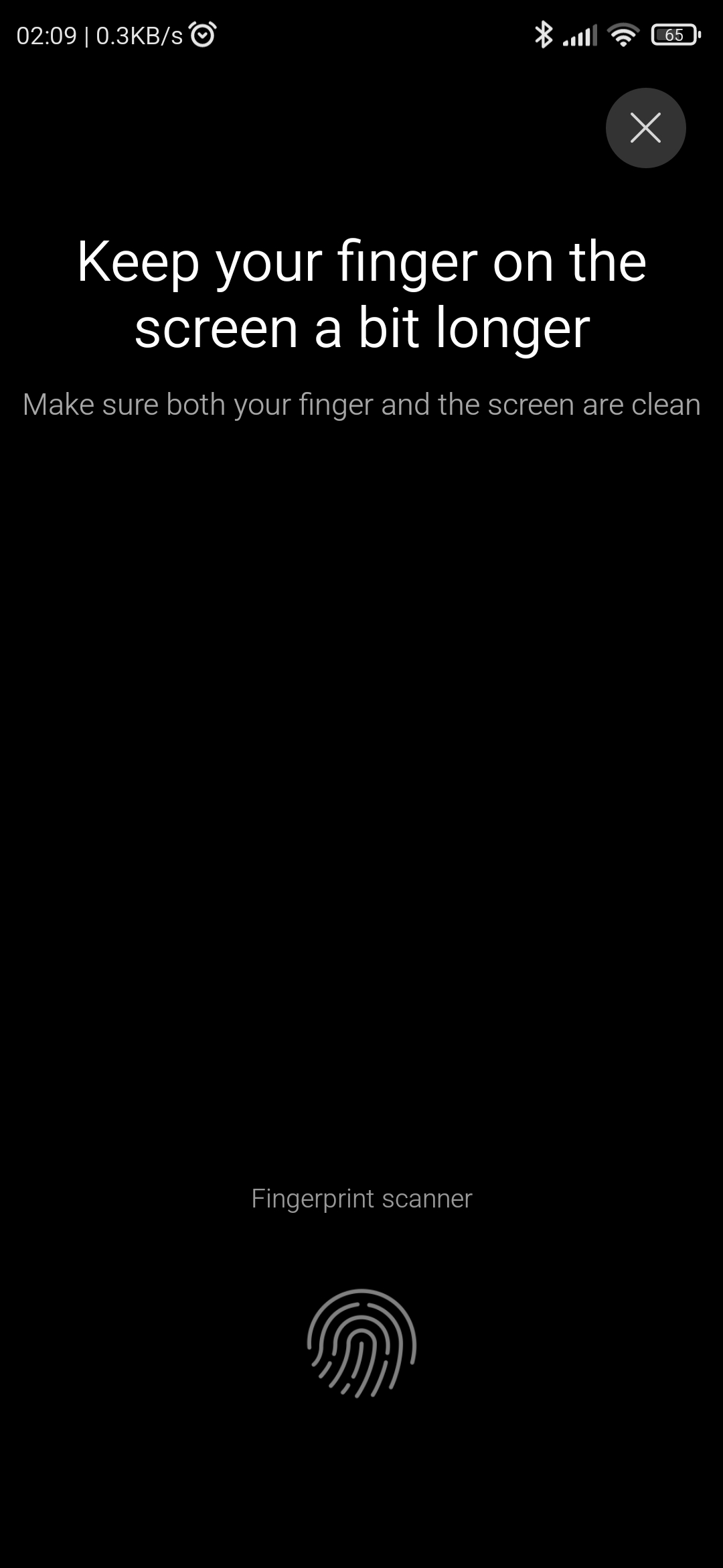

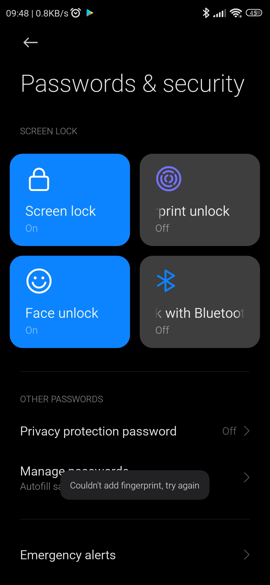

Hello, I recently installed MIUI 12.5 21.1.28 for Mi 9 Lite (CC9) weekly rom and once I was at the part to set up my lockscreen I couldn't add a finger print. Later on I went and tried again from the settings and it still said Can't add fingerprint, try again. I tried recalibrating it but got Performance_chart failed at the end.
Also I'd like to know why is it using a Mi 9 fingerprint instead if Mi 9 Lite
