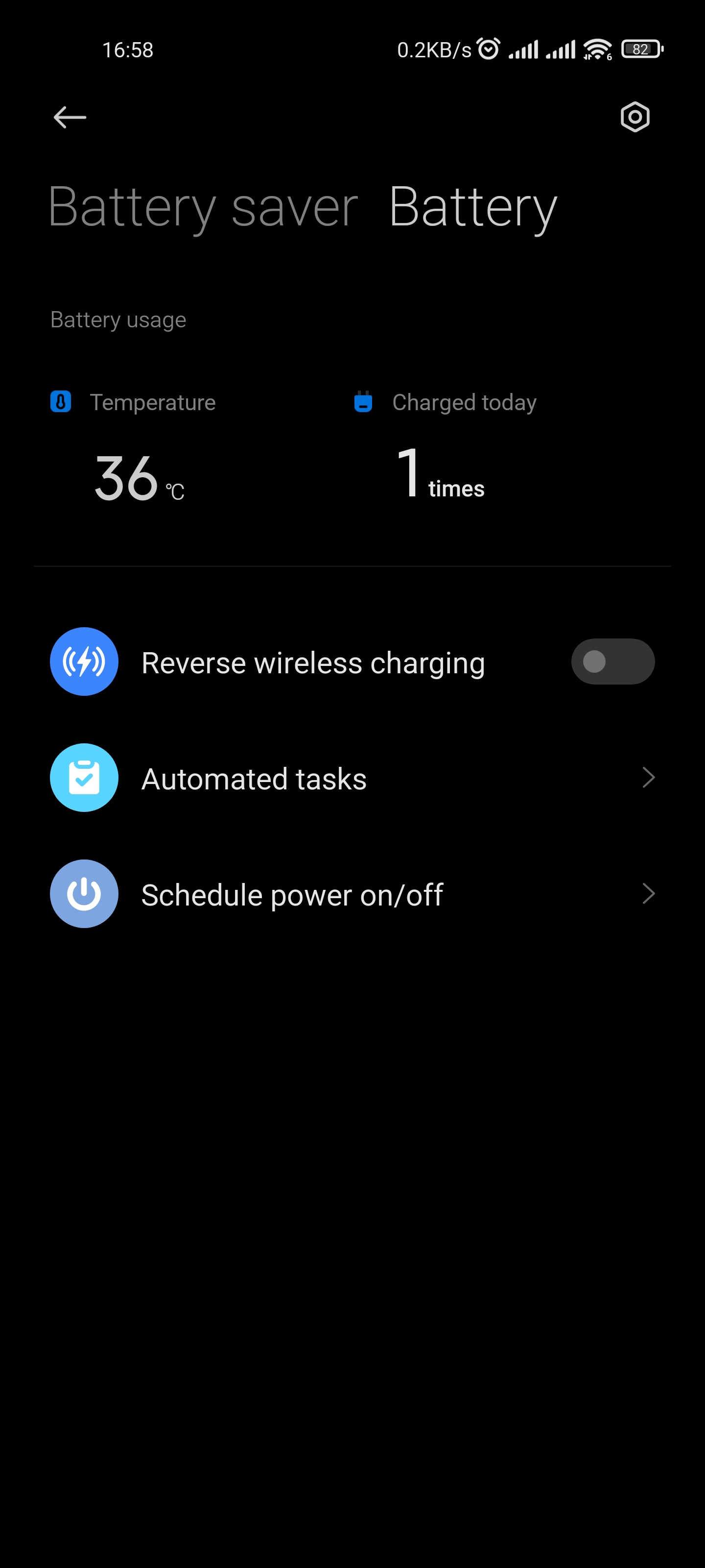

3. This is my phone temperature after 2 hours of continuous use. I use rom xiaomi.eu 12.5.7
37330

3. This is my phone temperature after 2 hours of continuous use. I use rom xiaomi.eu 12.5.7View attachment 37330
