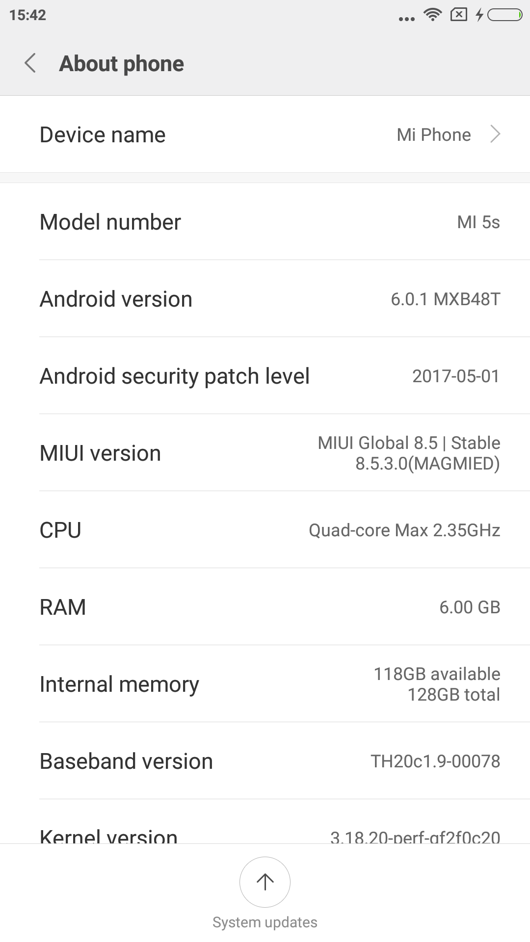

After trying to fix my mi5s PLUS stuck in bootloop for days I tried to flash a Capricorn rom. Which actually booted, is there any way to fix this and get it to run a Natrium rom?
And yes im 100% sure its an mi5s plus.

Will try, should i wipe and format in twrp before flashing?
Yeah, as i said im 100% sure. I have a mi5 and this is phone is bigger has dual cameras, fingerprint reader at the back and as you can see in the picture 6gb of ram.

Yeah I thought it was broken too. But then it managed to boot a capricorn rom.
Sounds very strange almost like you have a Capricorn motherboard but that's not possible since the dimensions between Capricorn and natrium are way off.
