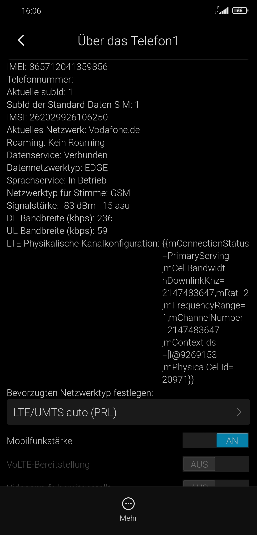

Preferred Network Type is set on GSM/WCDMA/LTE. I checked also the additional Options, especially the modem tools, in the CIT Menu. There it was set to LTE/UMTS (PRL).
Anyway, if I set one of them to LTE only i just get no signal. Meanwhile I think this is a hardware defect... or maybe you have another idea?
I also reset the APN: nothing changed. And setting up the APN manually for vodafone didn't help either.

I dont know really what I can read there (LTE discovery) but I get only information about my EDGE Connection. Every LTE related section is marked with N/A.
