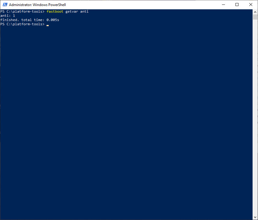

I have read on the net that many users have had brick problems due to the anti rollback inserted starting from miui 11 on xiaomi mi 9 ... Your rom xiaomi.eu on mi 9 contains this protection ?? I would like to avoid the brick .. I already have xioami.eu 9.9.6 miui 10 installed and would like to do a clean install

fastboot getvar anti
anti: 1

Same here I flashed the China 9.9.24 closed beta and ARB didn't change... it was at 1 and still is at 1. I downgraded to Android 9.0/MIUI 10 Global stable with no issues. 2019-09-25_9-15-14.jpg
