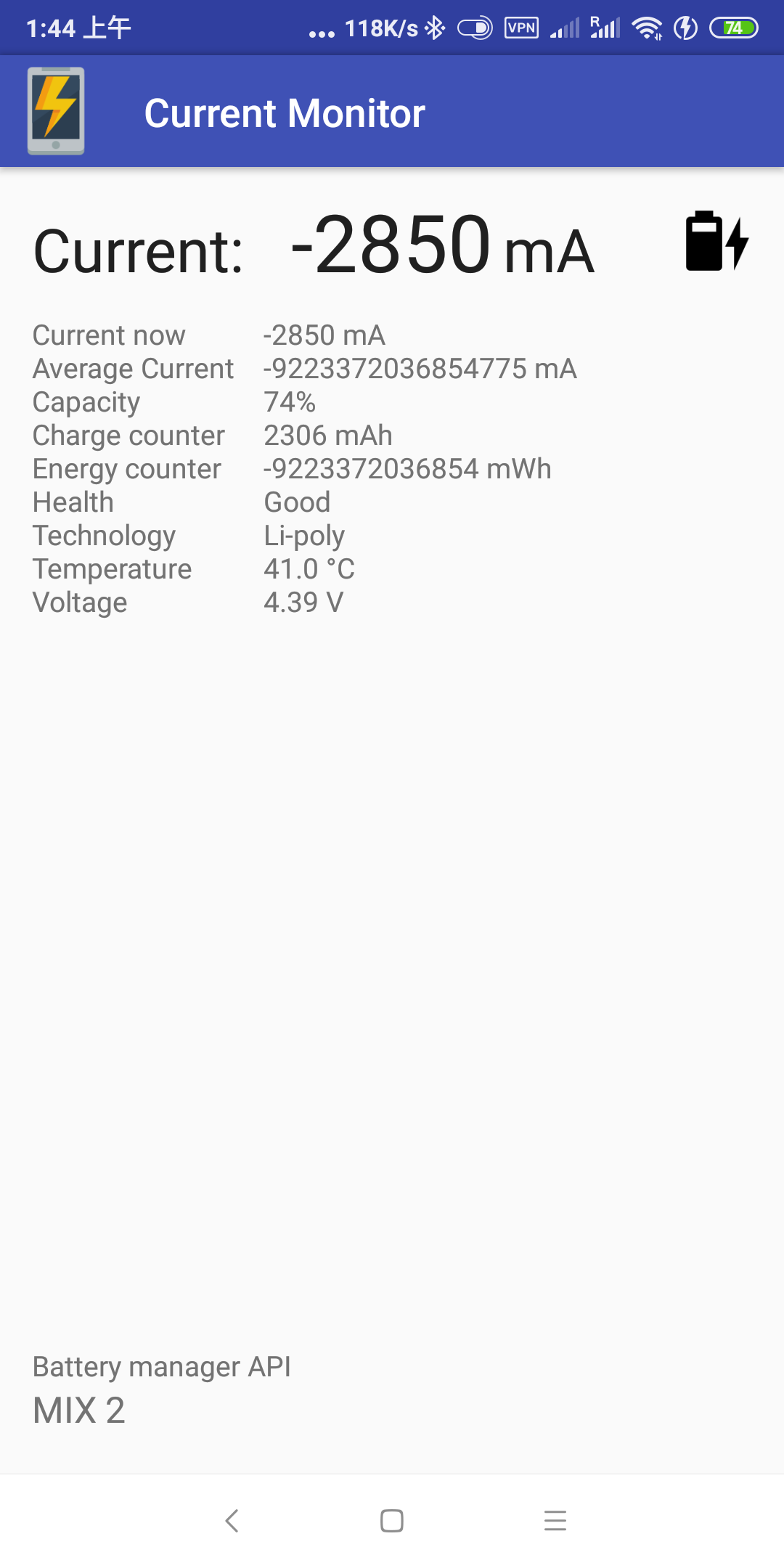

Hi i think it maybe is the thermal-engine-8998 conf after is delete those file the issue fixed but i am little worry the battery temperature over limited. because these files are binary, I don't know how to modify them. May MIUI eu them can help us change the temperature limit ?
We're not touching things like that. Then again, you said yourself - it's a binary file - we have no information on its structure or contents.
