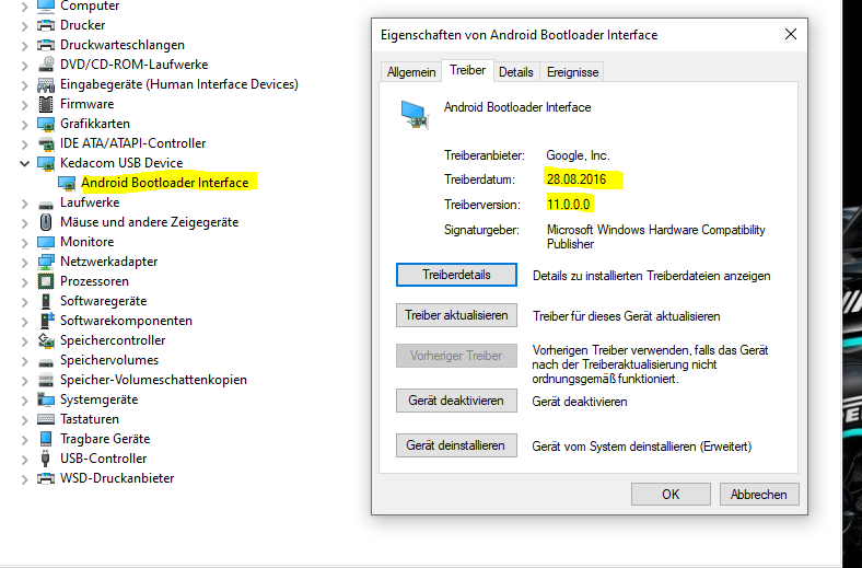

Do you hear the Windows sound when you plug in the Mi11 when it is in fastboot.
Which Windows do you use? I am using windows 10 and I never had to install a driver for my MI phones ...
The windows driver which will be installed automatically is enough
Screenshot shows my Mi11 in fastboot mode
35436
no sound when i plug in in fastboot, as i said, windows is completely not detecting the device in fastboot mode
