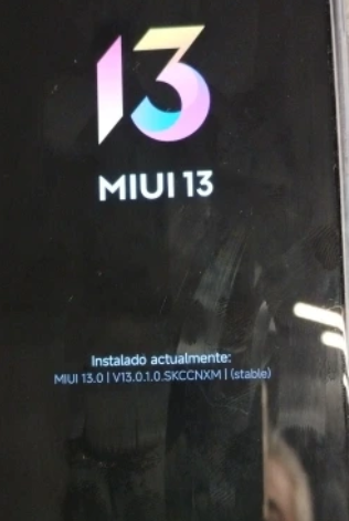

I managed to flash the new Rom, but with this one the 5G no longer works :,( and also have error in text format
ps. : the phone came whit xiaomi.eu 13 , and in the info the name of the phone was redmi note 11 pro 5g, but in fact is a 11e pro 5g. i don't know if it was installed the veuxg or veux before bu 5g used to work, instead now i have tried the last and the precedent last relase of stable 14 and 5g don't work anymore... now the name of the device is correct (as the box say, 11e pro) pls anyone help me, i will offer you a beer
this was the working version of software. if anyane can send me the link to the fil i will tank so much..
If you have an 11E Pro phone, you have VEUX software
If you have an redmi note 11 pro 5g phone, you have VEUXG software
Thanks for the reply, but unfortunately as I had already written in another post, the version you linked has big bugs in my VEUX... 5g not working is the main problem... while with the versions based on Android 11 and 12 it's perfect and have strong signal. the text is also bugged. wrong size and color, difficult to read often and not correctable by settings or by changing theme or downloading font pack.
