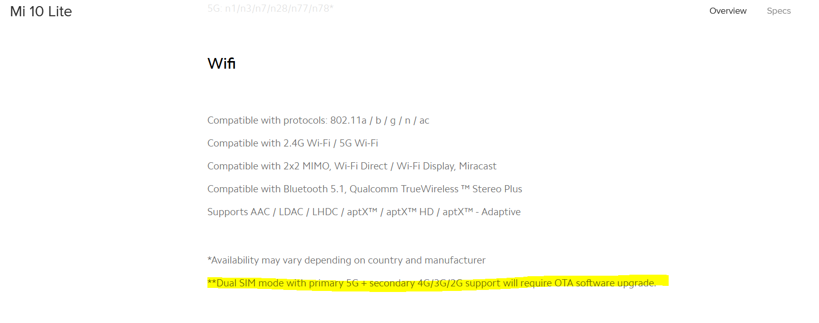

Great news!! Do you have some source or webpage that explains the issue and what's xiaomi doing to fix it? I'd like to know more about it :)
From Mi 10 Lite :)
Officially Mi 10 and Mi 10 Pro does not support dual sim... at least officially...
