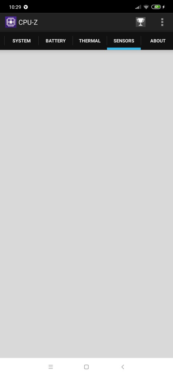

Good Night, when I install 20.03.26 on redmi note 8, I lose my sensors.. anyone can help me?
Note: I make two clean flash.. amd nothing..

Maybe this works for Note 8 too
Seems to work at least for Note 5 and 7
Make a Backup of persist.img before trying this
  • download the full image for your phone from this URL: https://mirom.ezbox.idv.tw/en/phone/
  • unzipp it and search for this file "persist.img"
  • make a backup in TWRP from your "persist partition"
  • install the image - there are 3 options
    • install with TWRP: install -> install image and flash the "persist.img" into the "persist" partition (as lolo told)
    • install with MiFlash
    • install with adb: "fastboot flash persist persist.img"
