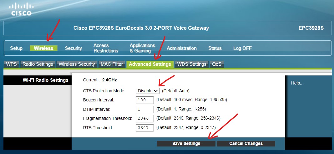

I have found the solution to this problem. The problem was with the settings on my Cisco modem. Please see attached.
In the Cisco modem wireless advanced settings CTS protection mode had to be set to “Disabled". Other brands of modem may have a similar setting.
  1. Connect a PC To the modem using an ethernet cable.
  2. Open your internet browser and type: 192.168.0.1 (For Cisco EPC3928AD Router)
  3. User name “admin”. No password by default.
  4. Go to Wireless Settings/Advanced settings/ CTS Protection Mode DISABLE/Save settings and exit.
Please see your documentation for other brands of modem.
Now the doorbell works properly. I hope this information may be able to help someone else with a similar problem.
Kind regards
Chris
