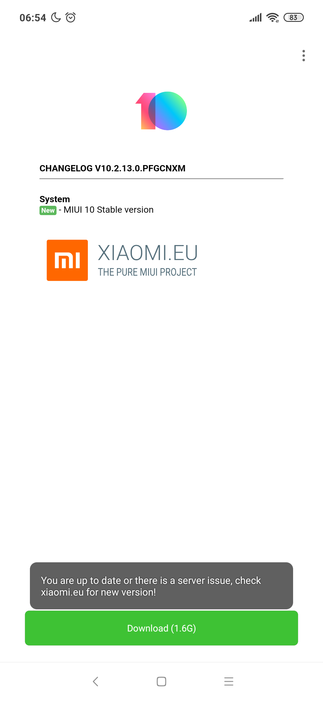

I try to update rom but it's not working...
Here's printscreen of what I have.
If I download rom from server is it possible to install it without loosing datas?
Nobody for any help?
The Updater app is buggy. Try to press the Download button for at least 15 seconds and the download should start. If not just download the rom manually from the download section in the site, reboot to Twrp and install it, clear Dalvik and Cache and reboot. Done.

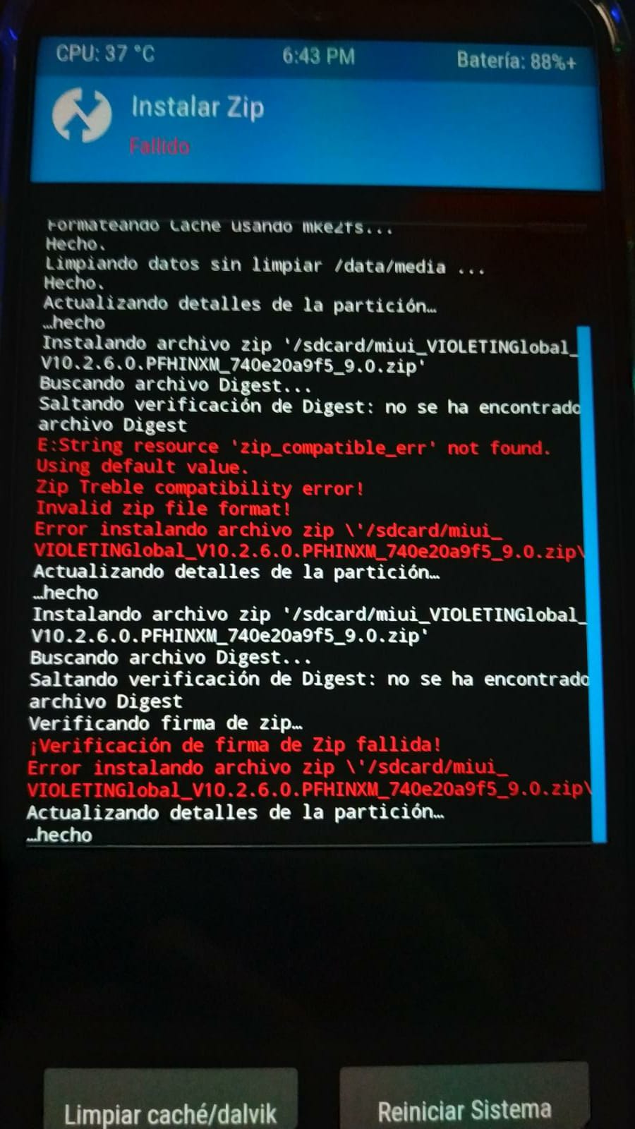

I try as you say, as you say and using twrp and I can not install the Global Indian ROM in redmi Note 7 Pro,
was giving error,
I had to do it with Pc and My flash.exe

OMG. Let it be. You try to flash a wrong ROM. ( miui_VIOLETINGlobal_V10.2.6.0.PFHINXM_***.zip )
ROMs from this website are named xiaomi.eu_multi_***.zip Your ROM is not from this website (Xiaomi.eu).
Flashing random ROMs from different sources will brick your phone. Please read the manuals before.
Never take ROMs from one source and tips or manuals from another!

but the rom Eu has not yet come out, xiaomi eu multi, for redmi note 7 Pro
I had to install the global india rom. .
I did it using My Flash.exe and Pc
