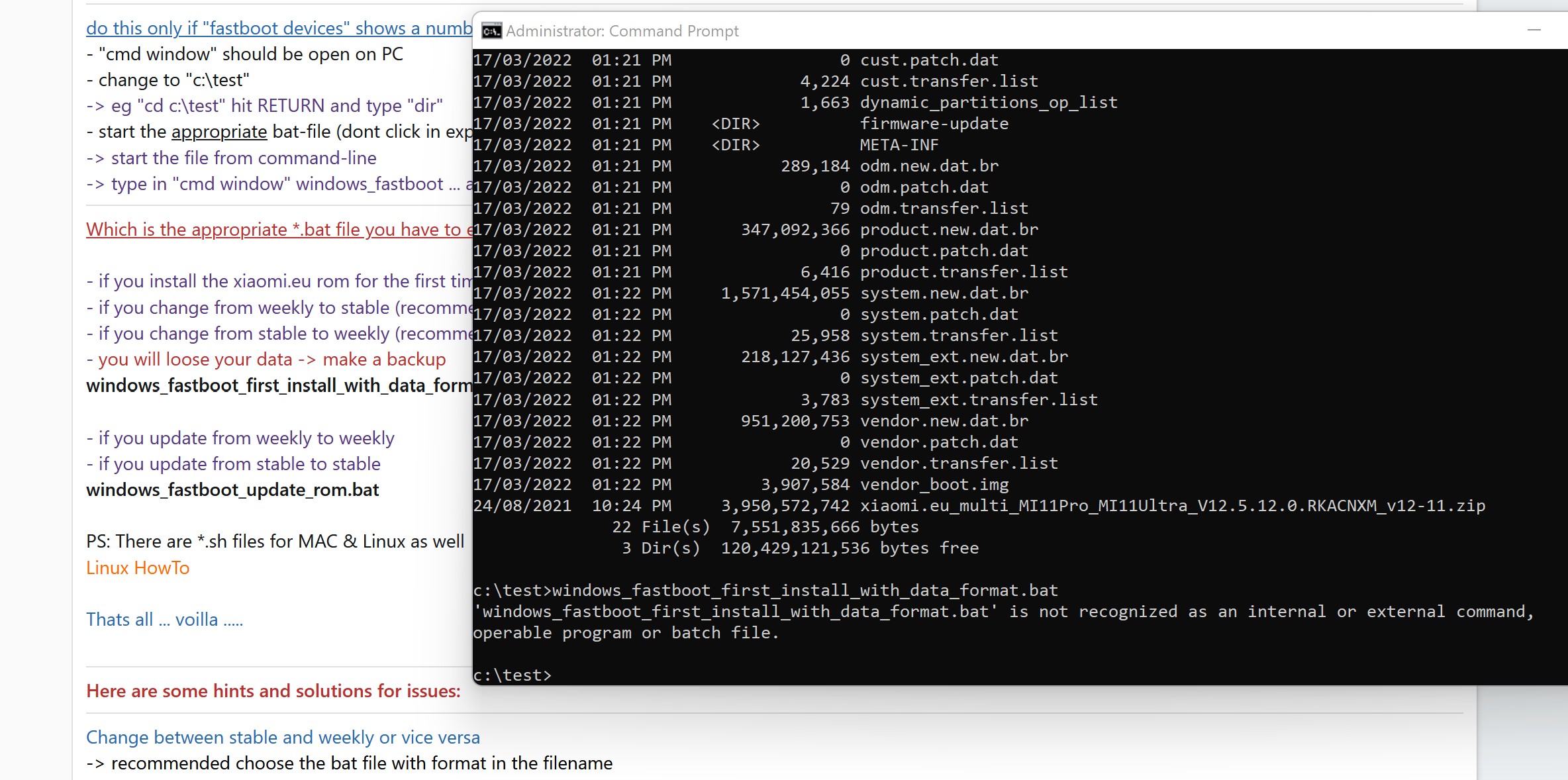

is there supposed to be batch files in the extracted rom zip? This worked fine when I did it with miui 13. Perhaps there are some files missing from the zip file i am using (mentioned in the first post).
