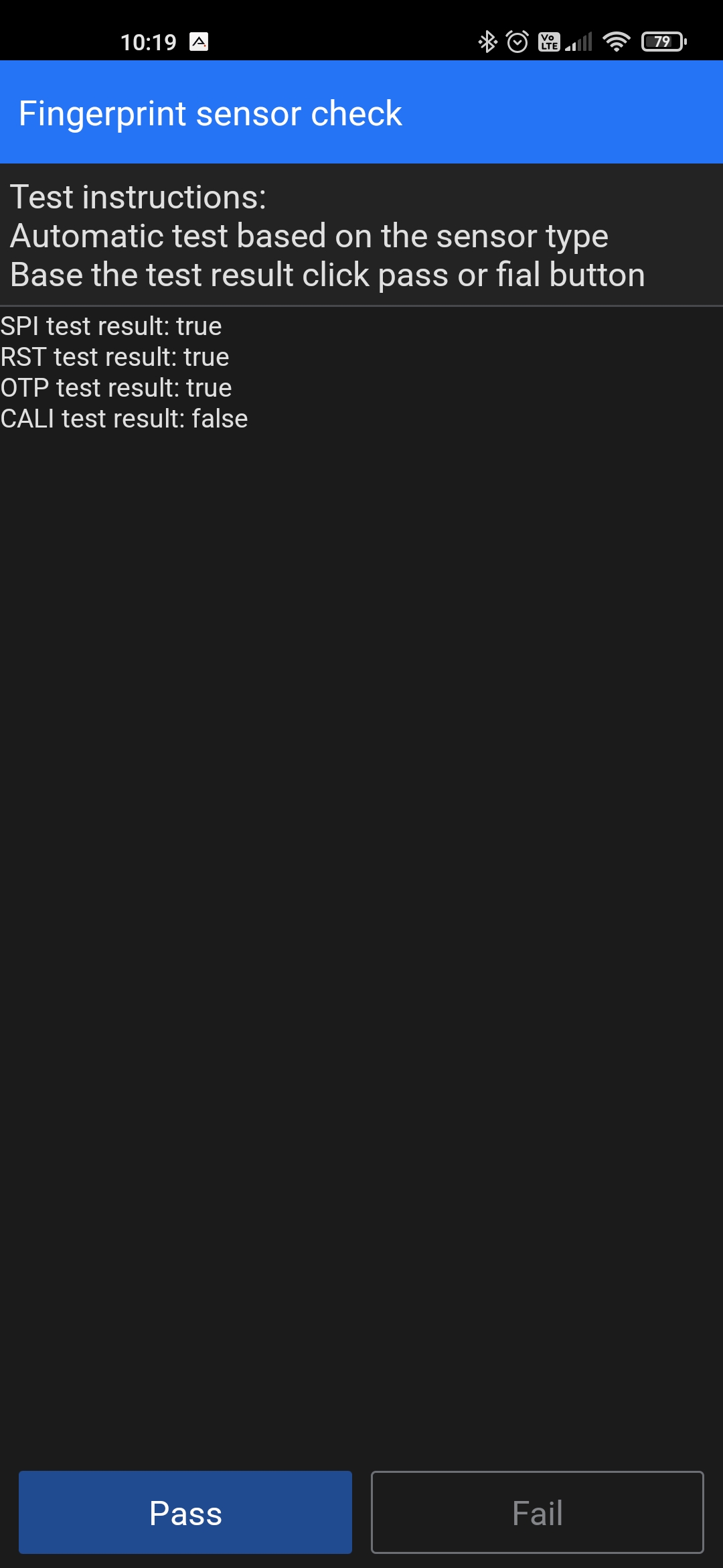

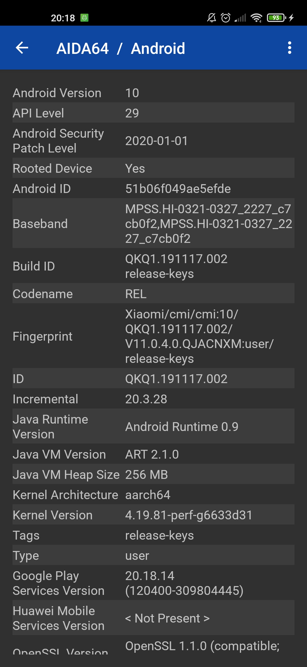

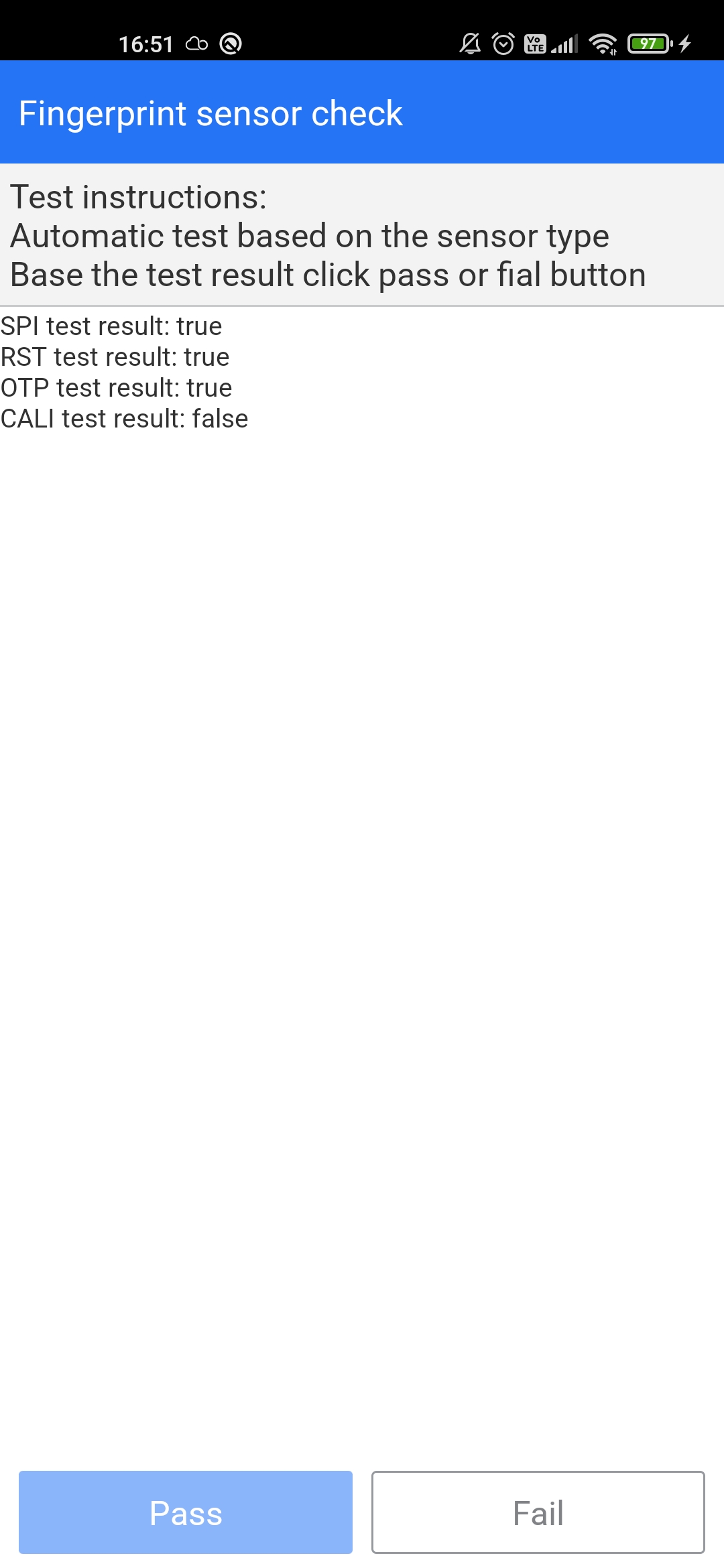

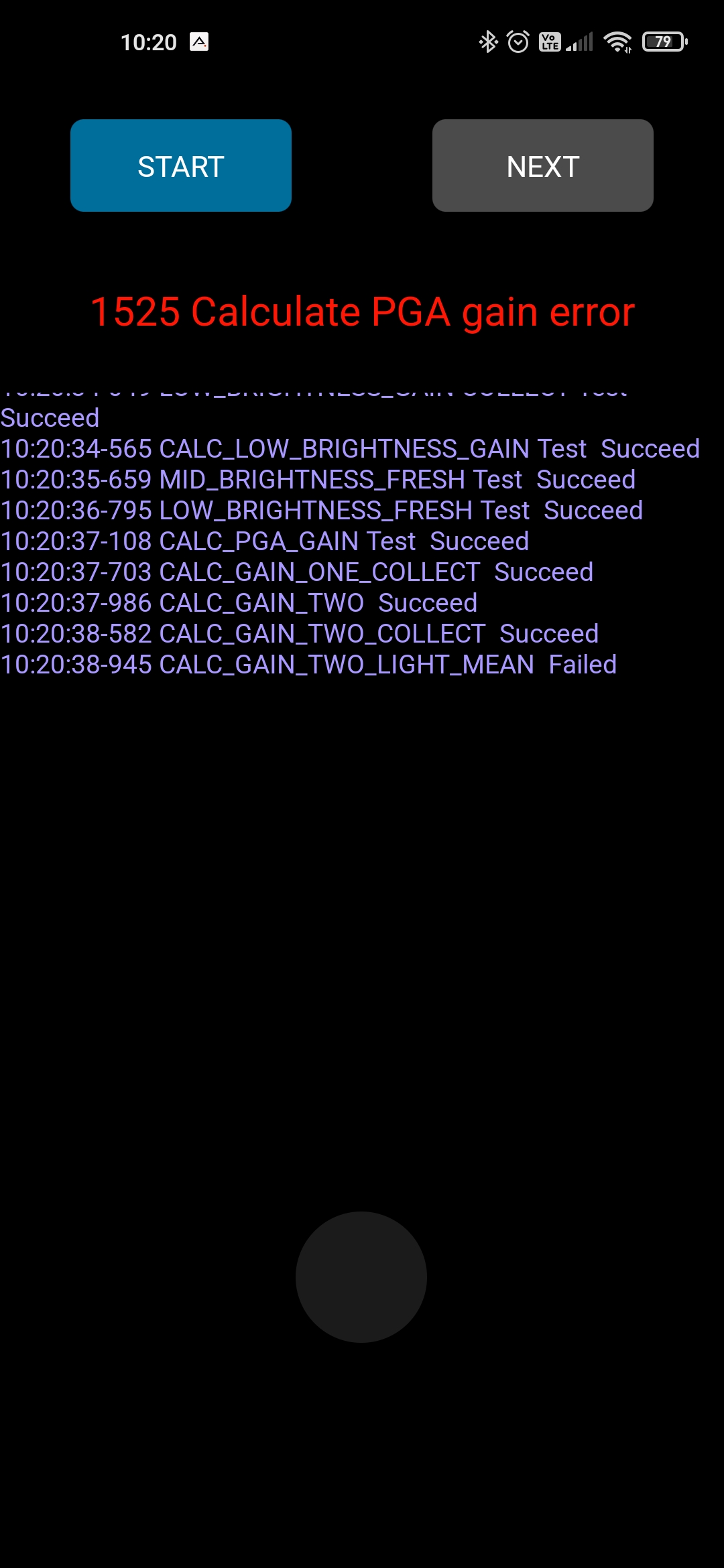

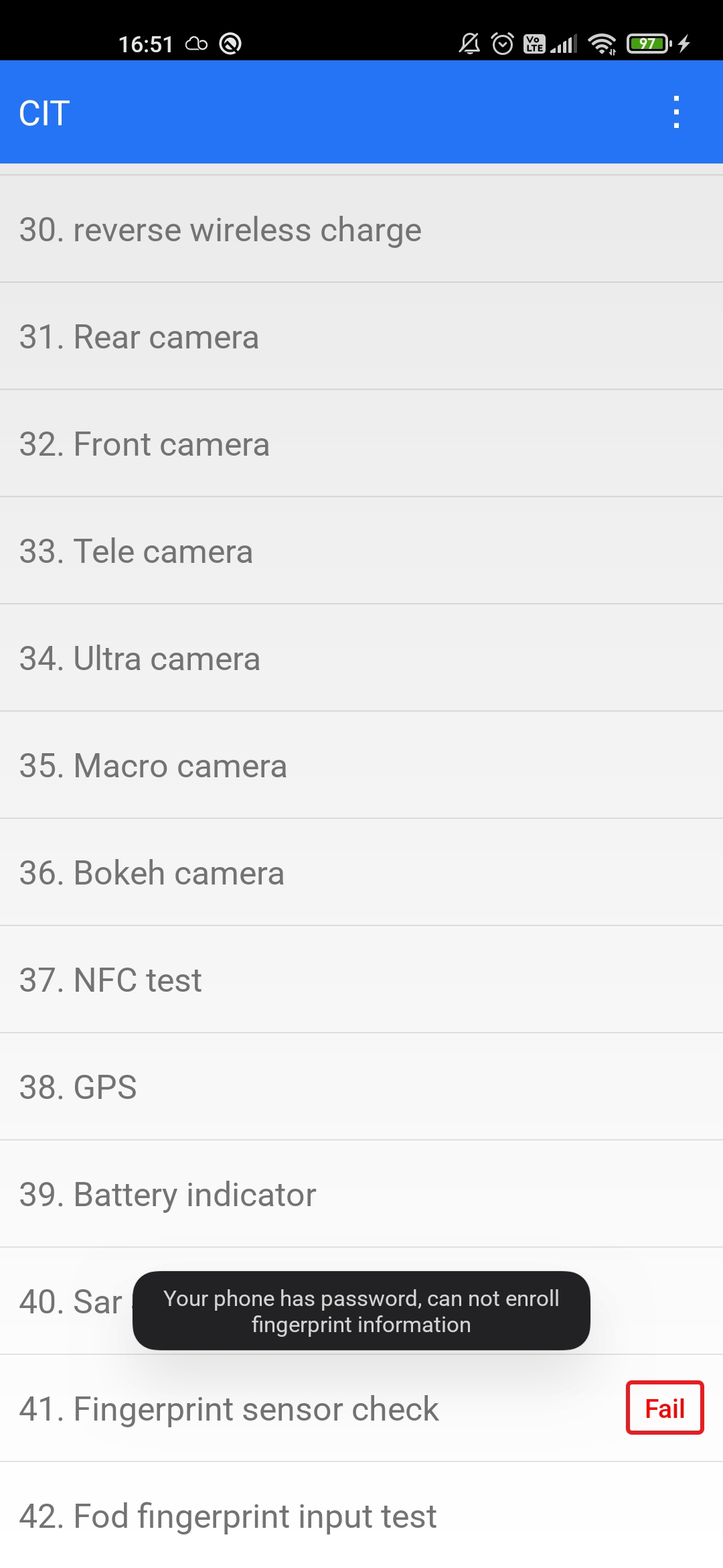

With so many ROMs back and forth one new one the old one I discovered that the fingerprint doesn't work and I don't know how to fix it I've done two or three times fastboot rom and again it doesn't work if anyone knows let me tell you photos tell me what it can be and where i can find it

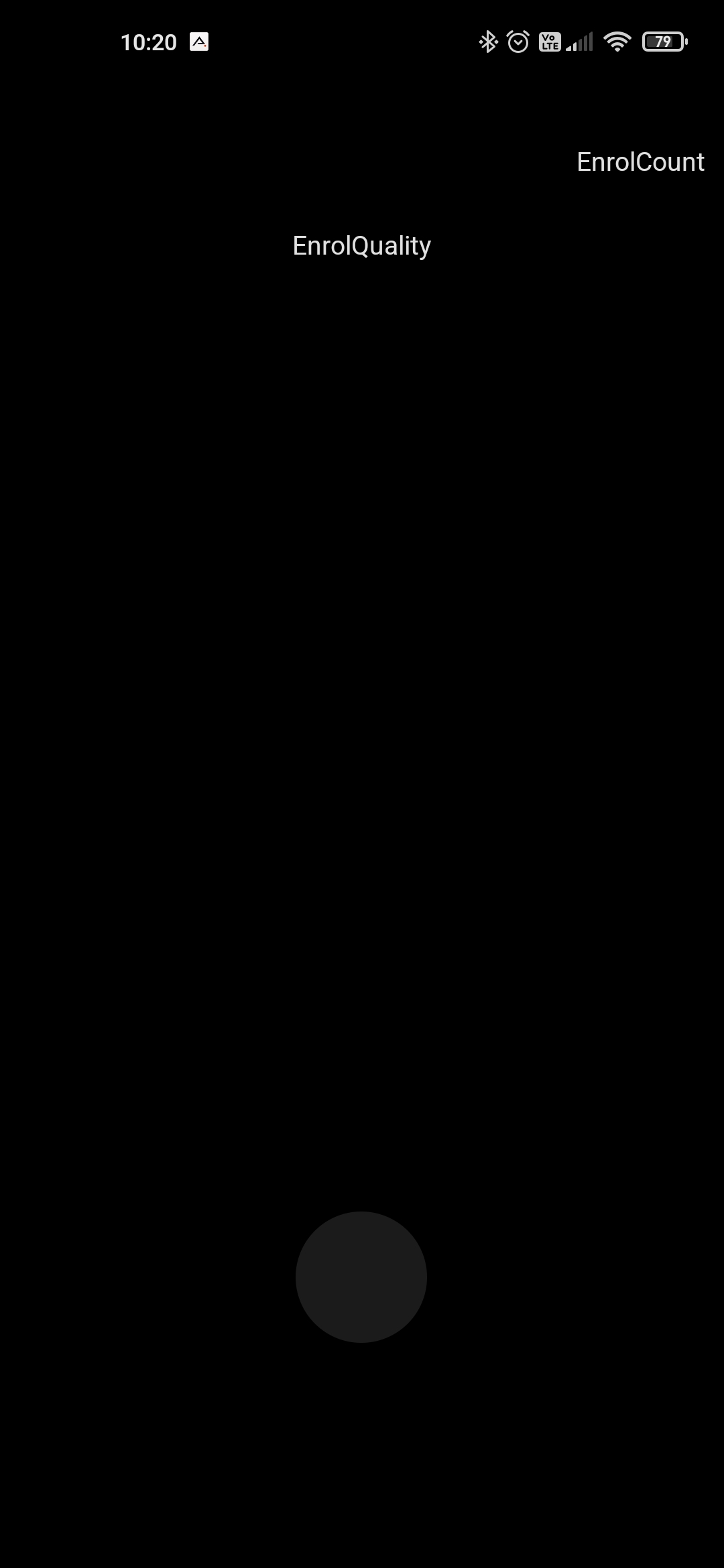

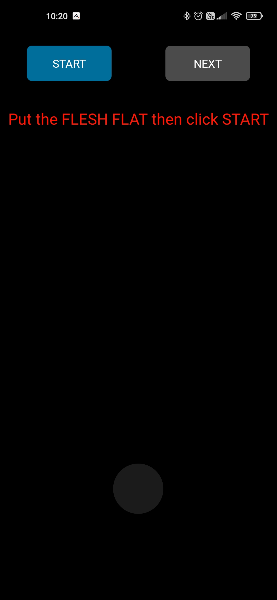

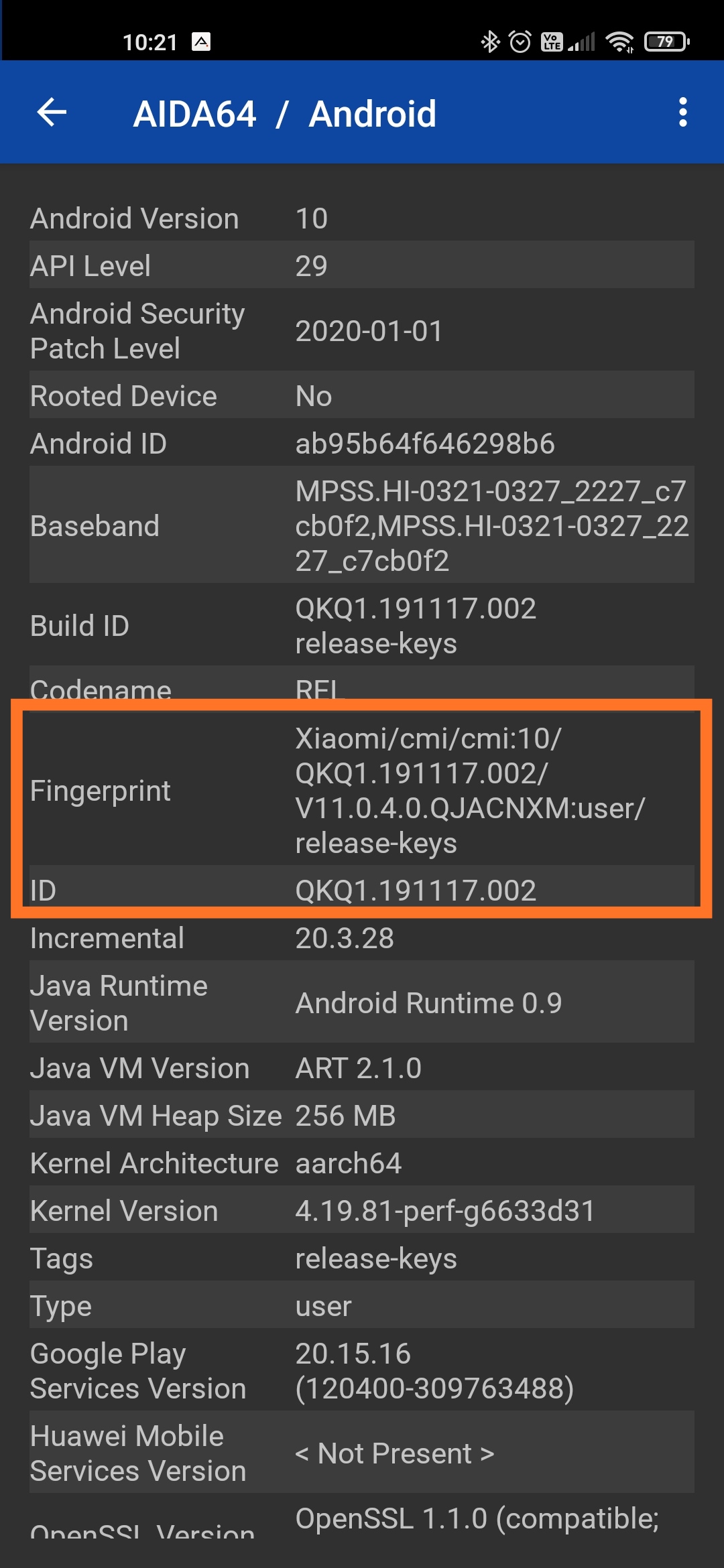

and now what am i doing here ??

Hello, I have the same problem as well. Did you know the problem solver or anyone who solves the problem.
I have the same problem with this friend. I have installed rom with fastboot. I have uploaded it unfortunately.persist.img is negative.
