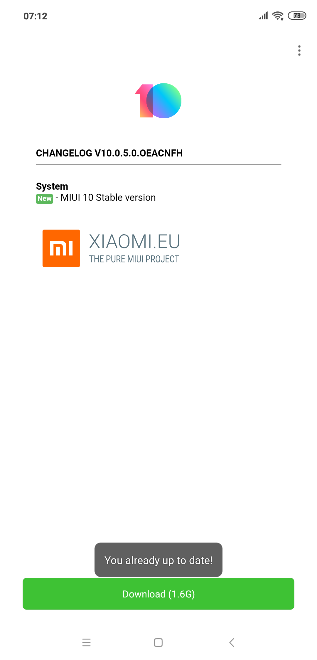

Can't update mi8 miui 10
if you want to go from the xiaomi.eu beta to the stable, you have to do a clean installation (with update via OTA, it has some problems updating, so I suggest you to manually download from the site), as I told you before a clean installation of helps to erase bugs, malfunctioning apps of the previous version (if you switch from beta to global = clean installation, if you switch from beta to beta = clean installation or okay), in this case I will show you which steps you need to do: 1) download files from xiaomi.ue (the stable rom) 2) turn off your smartphone and press the power button and volume up to enter twrp (if you have downloaded and flashato) 3) go to wipe choose 2 format data option and write and make a swipe, then return and swipe where it is written formact data, then return it again and this time choose the first option advacend wipe and select all the last used and confirm with a swipe.ritorni to the home 4) connect your smartphone to the PC, and drag the file (just downloaded) on your internal memory of the phone 5) with your phone now go to install and select the rom to download and then confirm with a swipe. 6) with the end of the installation you will see 2 options: choose the prizes and give a swipe, after which selection reboot system 7) at the start it will take a bit of time (about 2 minutes and 15 seconds) if you like it, put a like, thanks
