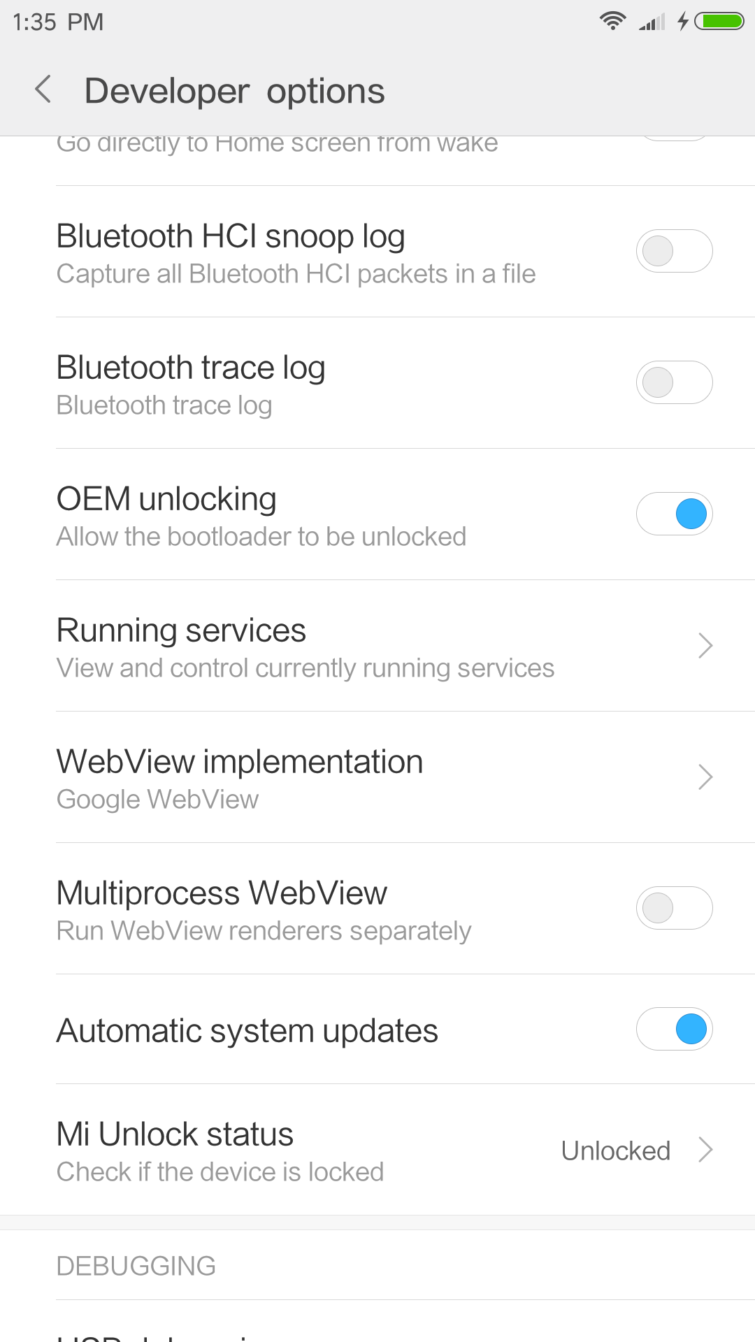

i tried many time´s to instal the xiaomi.eu rom and have still problems with the twrp. I hope somebody can help me.
I use the developer libra_images_7.3.23_20170323.0000.00_7.0_cn_2ded872f70 from original xiaomi.
The bootloader is already unlocked but the phone don´t boot to twrp.
bootloader is already unlocked ok. But you have to flash trwp for your device via fastboot. Did you do that?
