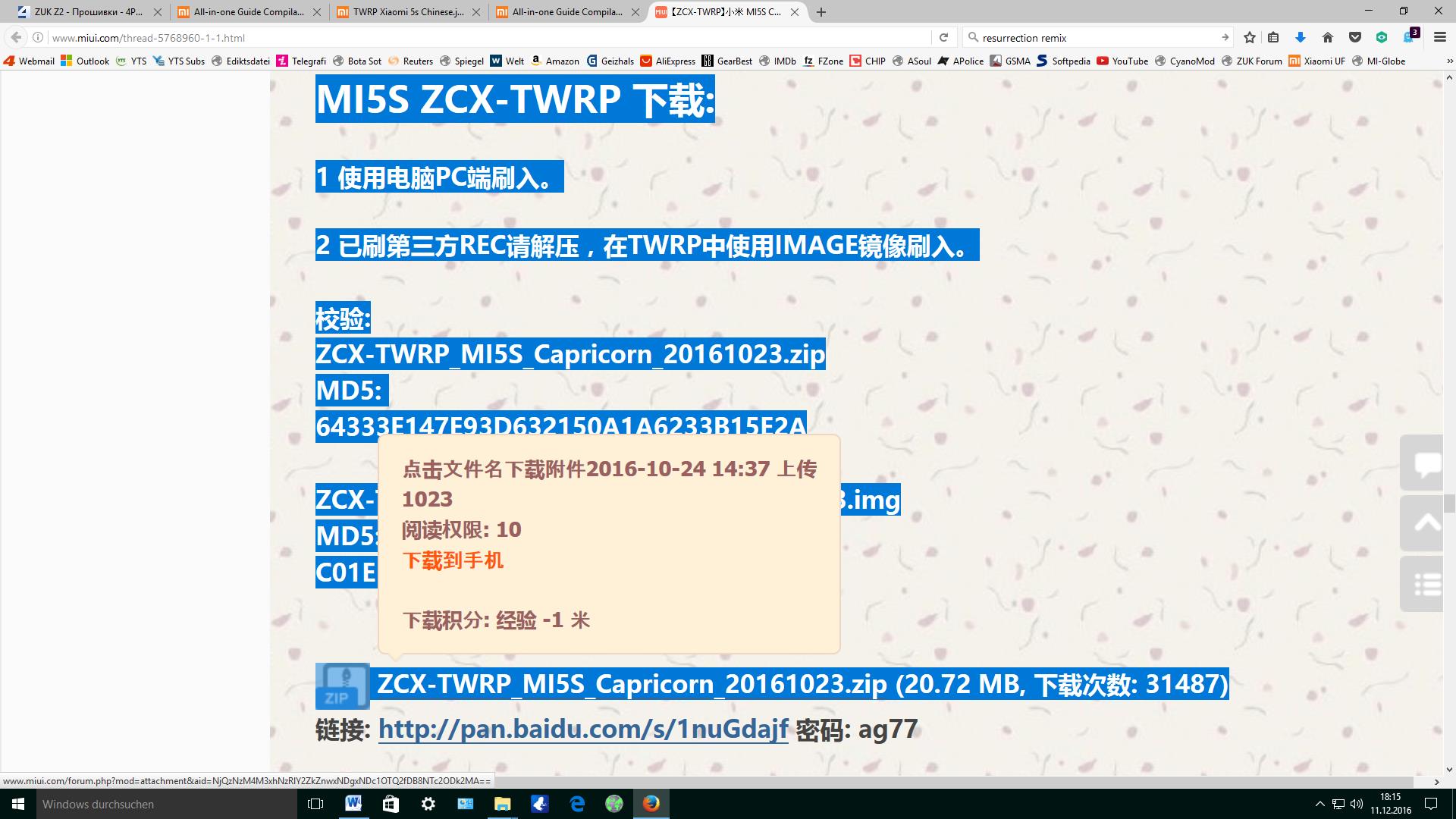

P.S.: If this TWRP does not work (for whatever reason)
https://www.androidfilehost.com/?fid=457095661767101599
then install the chinese TWRP (blue marked part in the attached screen shot):
http://www.miui.com/thread-5768960-1-1.html
